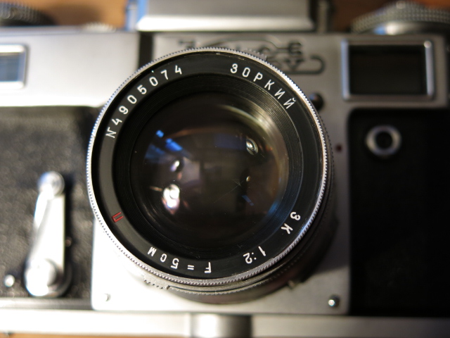

I aquired a Kiev-4 that seems to be in good condition. Even the lightmeter is quite in agreement with others. Fast speeds are slow. It's my first focalplane shutter rangefinder. What a funny thing..
The lens' name translates to 'Zorkij'. Now, it seems most Kiev-4 have a Jupiter-somenumber. When I look at Zorkij cameras on the net they seem to have Jupiters too.
I found the manunal at the Butkus site. But would anyone like to comment on this camera and lens?

Lens engraving looks a bit too clean to me... Sold with a Kiev 4, weird.

And what do you think of the ears on the aperture ring, just like a prewar Jena Sonnar?
Any "rare" soviet lens is suspect to me. Too many forged lenses these days...

I bought it from a box at a flee marked from someone who clearly knew nothing about cameras. Here is 2 more pictures.

Often a bit of knwledge will avert suspicion.
Lenses for the Kievs were first produced at Krasnogorsk, at least partially of Zeiss materiel - this explains the aperture ring.
Some early lenses were even put in collapsible mounts. Evetually lenses in Kiev mount were produced at Arsenal under the Jupiter designation, and production of screwmount Jupiters began at Krasnogorsk.

The lens you have is rare. It is one of the lens collectors are after. It is made in 1949 according SN and it supposed to be with original Zeiss glass which was expropriated by Soviets with entire factory and some workers after war.
Camera is also worth of extra money, but not as mach as this lens. And condition of the kit is also rare to find.
1949 factory catalog with your lens listed:
https://www.zenitcamera.com/catalog/catalog-lenses-1949.html

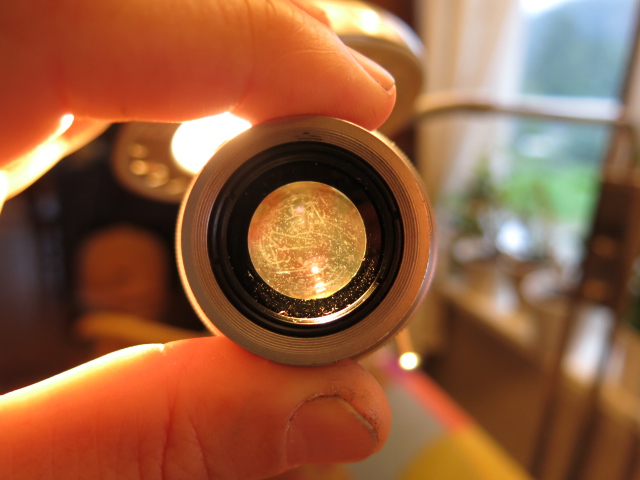

As I keep reading about this camera I wonder if this one has had a recent CLA and then for some reason rather soon ended on the flee marked. Externally the lens is clean and I can't see any scratches. Inside, however, it is not clean.
Thanks for the links!
Now, if Dali is right and the lens is a fake. Then what is it?

If your lens is a fake, then they've learned to fake 68 years worth of haze. It needs cleaning, it won't work well at all as it is.
The camera is from 1970, and also needs cleaning and lubrication. This can be a good thing - it means that neither lens nor camera have been ruined by internet educated tinkerers.
With use, the shutter might loosen up a bit, but there is a lot of mechanism in there, it needs to be very free to give accurate fast speeds.

Well, looking from inside, as it is shown on the picture, lens is scratched, but not cleaned. It doesn't sounds promising and very unlikely this lens is fake. The lens which was manufactured in later mass production was 50/2 Jupiter 8. In the link for 1949 catalog, your 1949 lens is described as ЗК-50/2 in Zorki and Kiev mounts.
