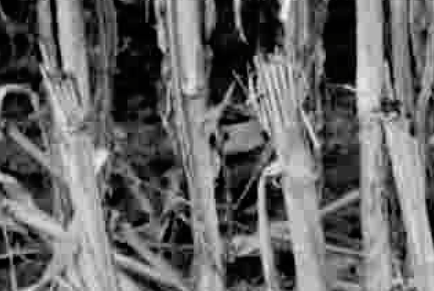

This is what happens with insane compression levels as sometimes used by low-end labs/services. 200% view.

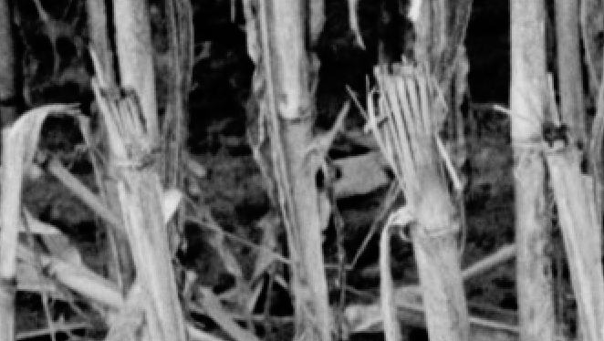

Same view, but on an image with far less compression:
