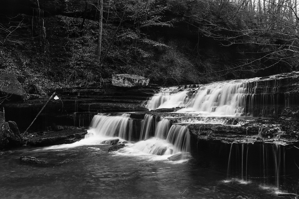

Above developing method. First is with a Nikon FM and series e 28/2.8 w/ yellow filter Second is a Canon A1 or Ae1 with chrome nosed 35/2 (slightly yellowed from thorium, no filter)

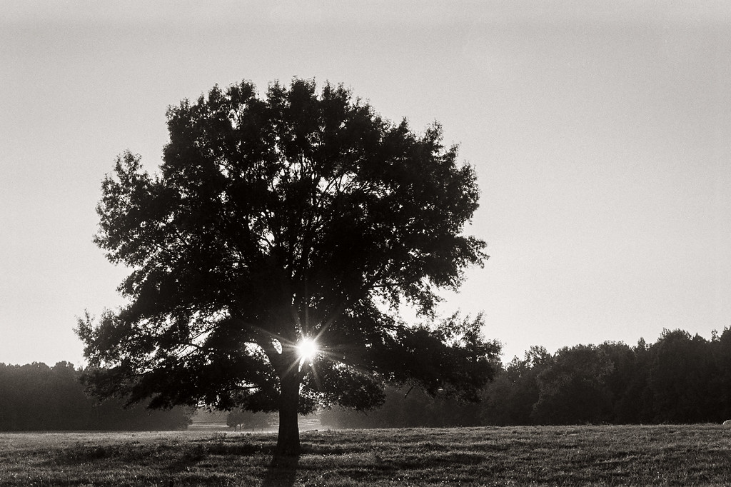

Haven't been using much hc110 lately (on an id-11 and rodinal kick) but here are some from last year with kentmere 400. Same developing technique I posted above.
with om10 and zuiko 50/1.8
and with an oly XA
https://photos.smugmug.com/photos/i-jh6kncw/0/XL/i-jh6kncw-XL.jpg
looks like my notes are 14minutes with slight agi every 2 minutes dilution h. Later in my notes I have a star 13.5 minutes at 68 deg. Either 13.5 or 14 would work well with kentmere 400. Granted these were scans with some slight (levels, sharpening) in LR5

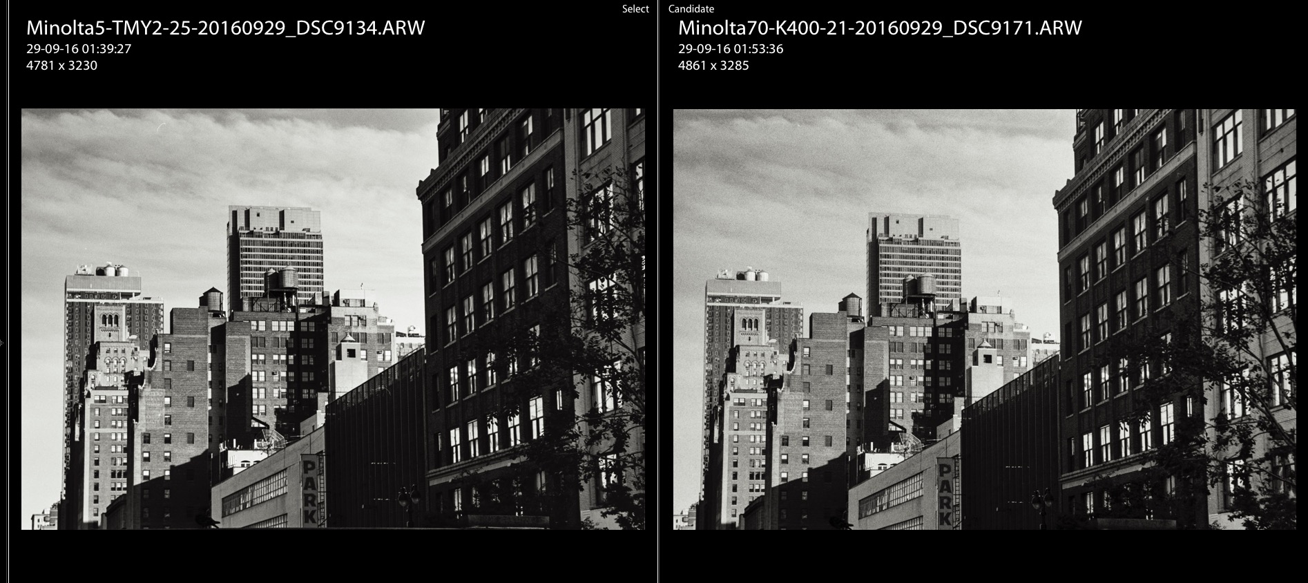

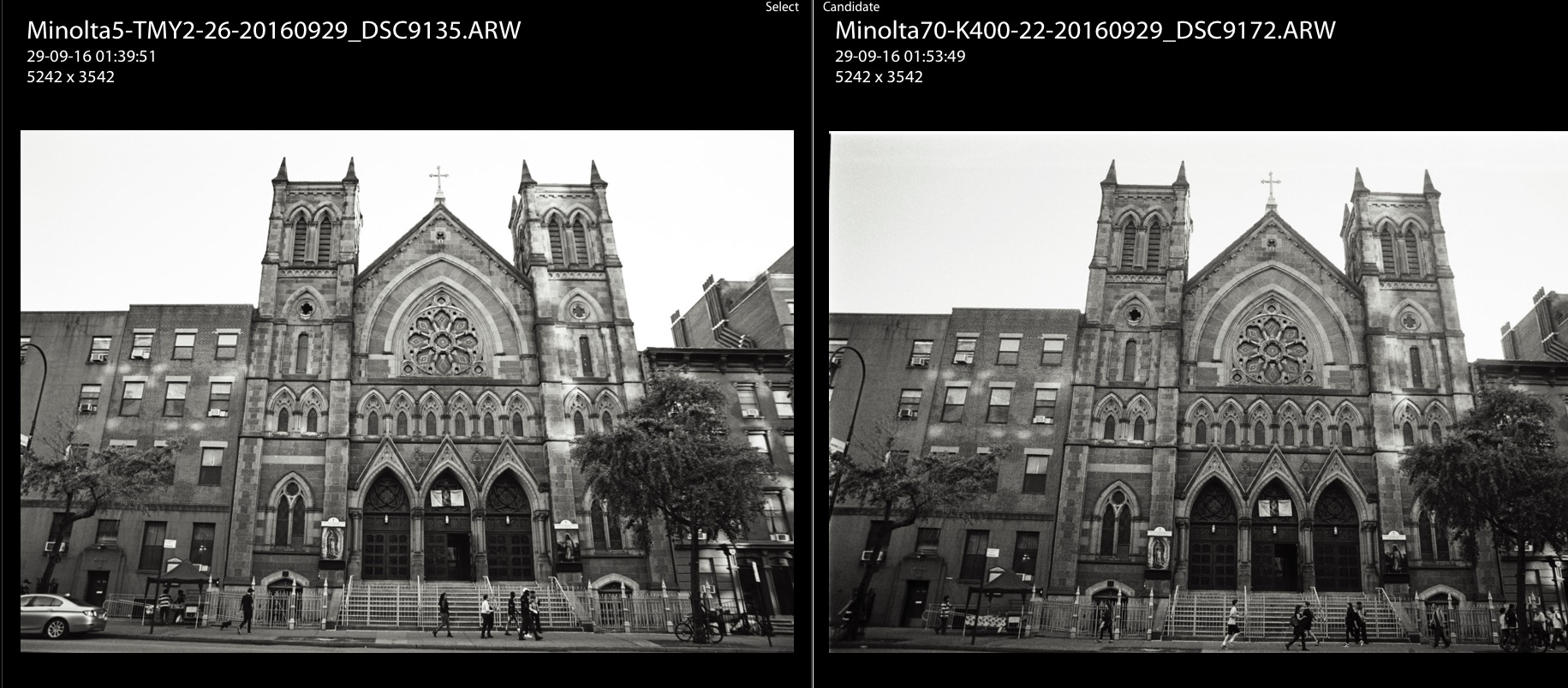

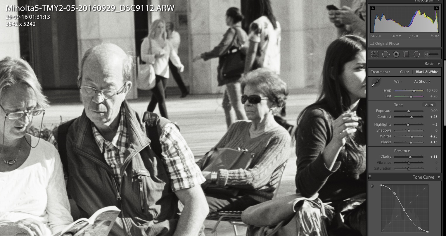

Here are my samples
Kentmere 400 and T Max 400, developed in Xtol 1+1 according to the Massive Dev Chart. Negs digitized with Sony A6000 and macro lens over a lightbox.
Cameras were Minolta Maxxum 70 and Minolta Maxxum 5 with Minolta 24-85 mm AF.
had to increase the contrast a bit in Lightroom. I wonder if with HC-110 I'd get some deeper blacks and brighter whites out of the tank
Compare full frame and some 100% and 50% crops
PS first image of buildings was cropped about 15% to a tighter crop
