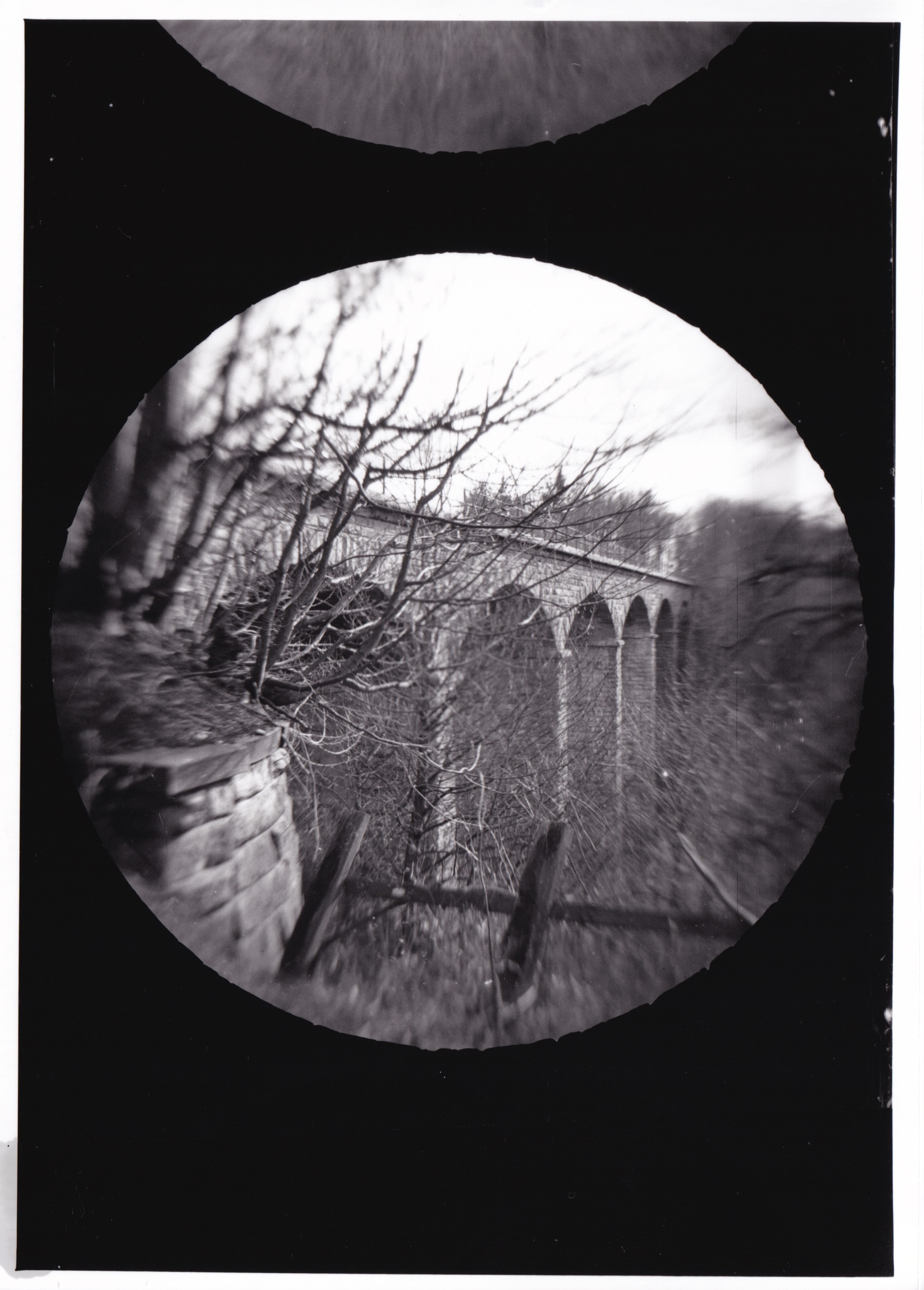

A long time coming but I did manage to source a lens that fit into the Kombi; only just I must add. It proved to be a success as the camera has produced good images. Regardless of how careful I am, as the film passes over the metal rollers and between the platen and film mask 'sandwich', it scratches. It's unavoidable but I can live with it since it's such a unique camera and one that hasn't seen much use in the past century.
I've made around 30+ images with a number of those being printed in the darkroom. I cannot prove this, but I believe this could be the first time in a century or more that the Kombi has had prints made from it; one of which I've attached.
Overall a fun project and a camera I plan to keep on using.
