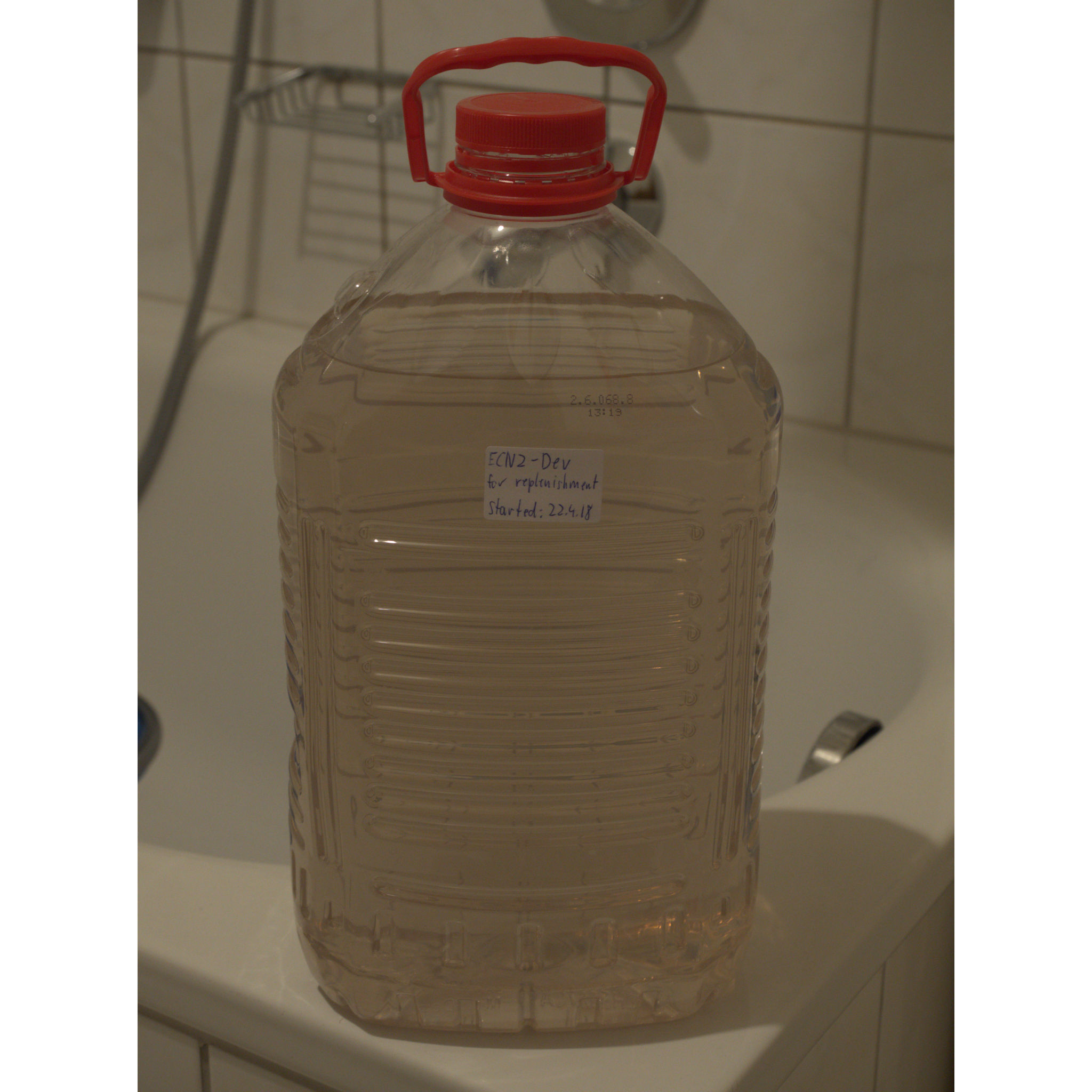

I mixed 5L of ECN2 developer last weekend and filled it into a 5L PET bottle. My deionised water from a particular drugstore comes in those.
I don't expect trouble with it... I hope.

PET is succeptible to high pH.
But chemical stability charts typically only refer to single chemical solutions as aggressive medium, not complex solutions. If I remember right just a few weeks ago we got a warning concerning PET and E6.
Also there are at least over here different grades of PET beverage bottles, as single use and returnable bottle, which differ in wall thickness.
