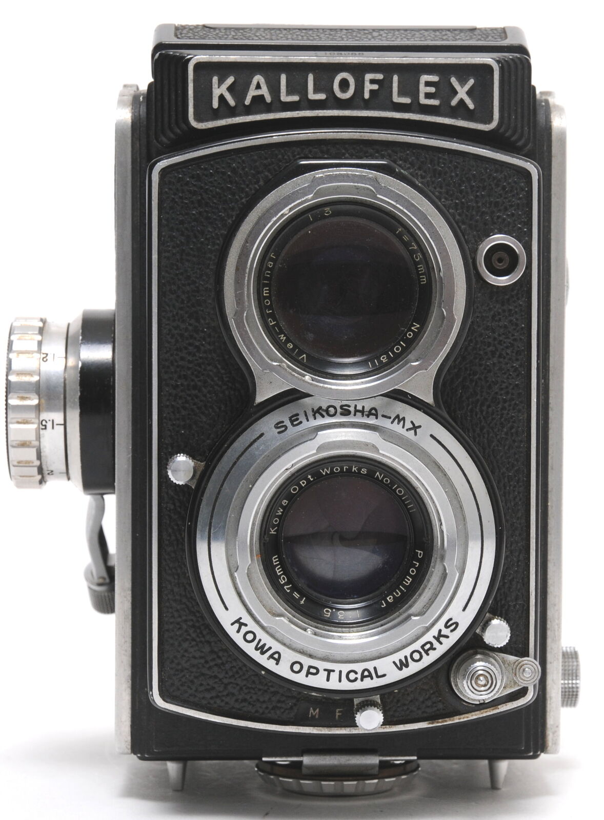

I bought a Kowa Kalloflex model 2 (K2) and I need to fix it. Shutter was not working, but when the camera got warmer it opened, but then it got stuck open and won't close again. I also need to clean the focus screen, mirror etc...
However, the thing I noticed last and which I haven't experienced before, was that if I try to focus at infinity and let go of the focusing knob, it rotates back to 7m. It only happens at this end, at 3m or 1.5m it stays. Has anybody repaired a Kalloflex and experienced this and know what is the issue. I find no repair manual online.
Only positive so far is that aperture looks dry and clean and the taking lens looks also very nice.
Thanks for any hints in advance

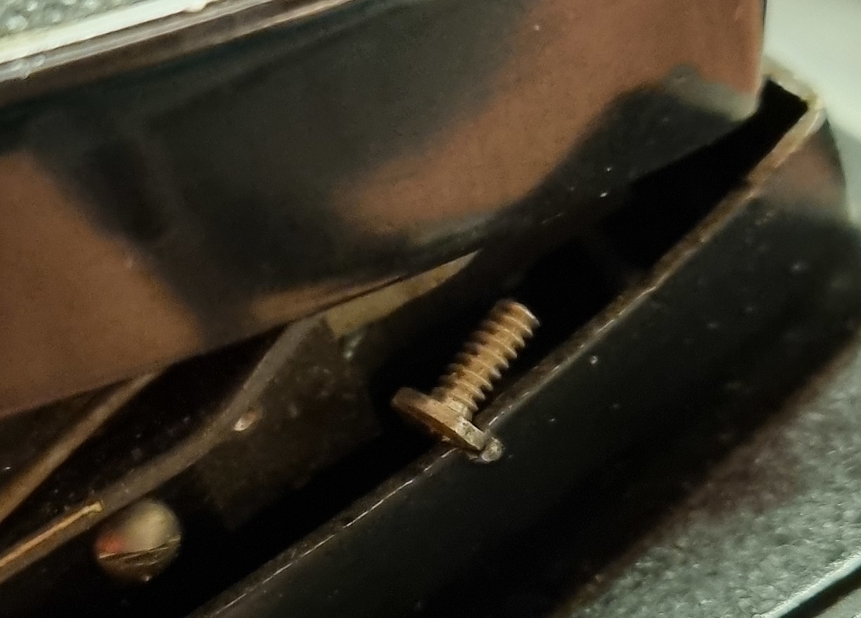

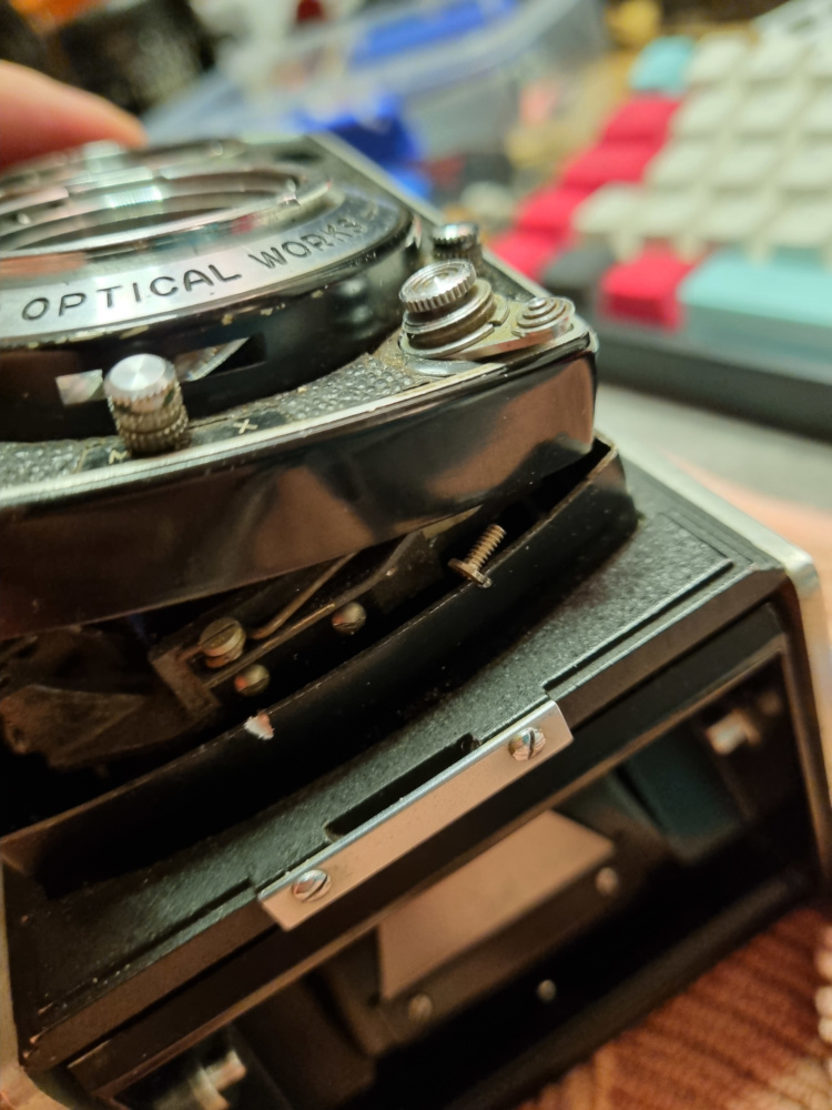

I found the problem as I opened up the camera front to get to the shutter and I found the problem. A screw had been driven into the metal where the focusing mechanism goes. When I focused to infinity I was compressing the screw, which then pushed back when I let go of the focusing knob. I don't know where this screw is coming from as I see no holes with missing screws. Possibly somebody lost it inside and it came stuck at a later point. Glad it was only this and not some complicated mechanical issue.

Looks like the kind of screw that would hold the lens board to the focusing rail, or the lens shroud in place, or a side pane in place.
