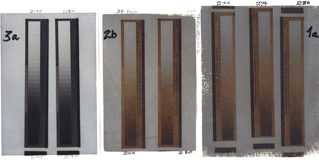

Further tests with my "fog" 3 different types of paper (attached) the 3rd is what I like colour wise but that silver grey fog still there even doing everything in near darkness.
Is this a chemical fog or paper issue?

Since you have tested your safelight, these all look like a paper issue. The unexposed areas should be the same as the original paper.
Have you tried processing a piece of paper which has not been exposed to UV? This could lead to a clue.

Jim Thanks! I tried a bit of sensitised paper and developed without exposure to UV and yes it is silver grey too.
The masked areas of the greycale tests I attached in my previous post also recieved no UV light.
Does this point to my sensitiser or more likely the paper? Cheers!

The paper example on the left looks like your best bet. The best developer I've ever tried is sodium citrate. Make sure your initial rinse after development is slightly acidic (a half a teaspoon of citric acid crystals in a bucket of water works for me) Clear print in 30% citric acid. Fix with 50g per litre of sodium thiosulfate (hydrous; or 25g anyhydrous) and 50ml ammonia for one minute.
Paper. Arches Platine is very nice and doesn't require acidifying. The same goes for Lana Aquarelle. Expensive, but worth it. I use these papers as well as Stonehenge, which requires acidifying.
Your issue is probably your paper, rinse, and clearing bath.
