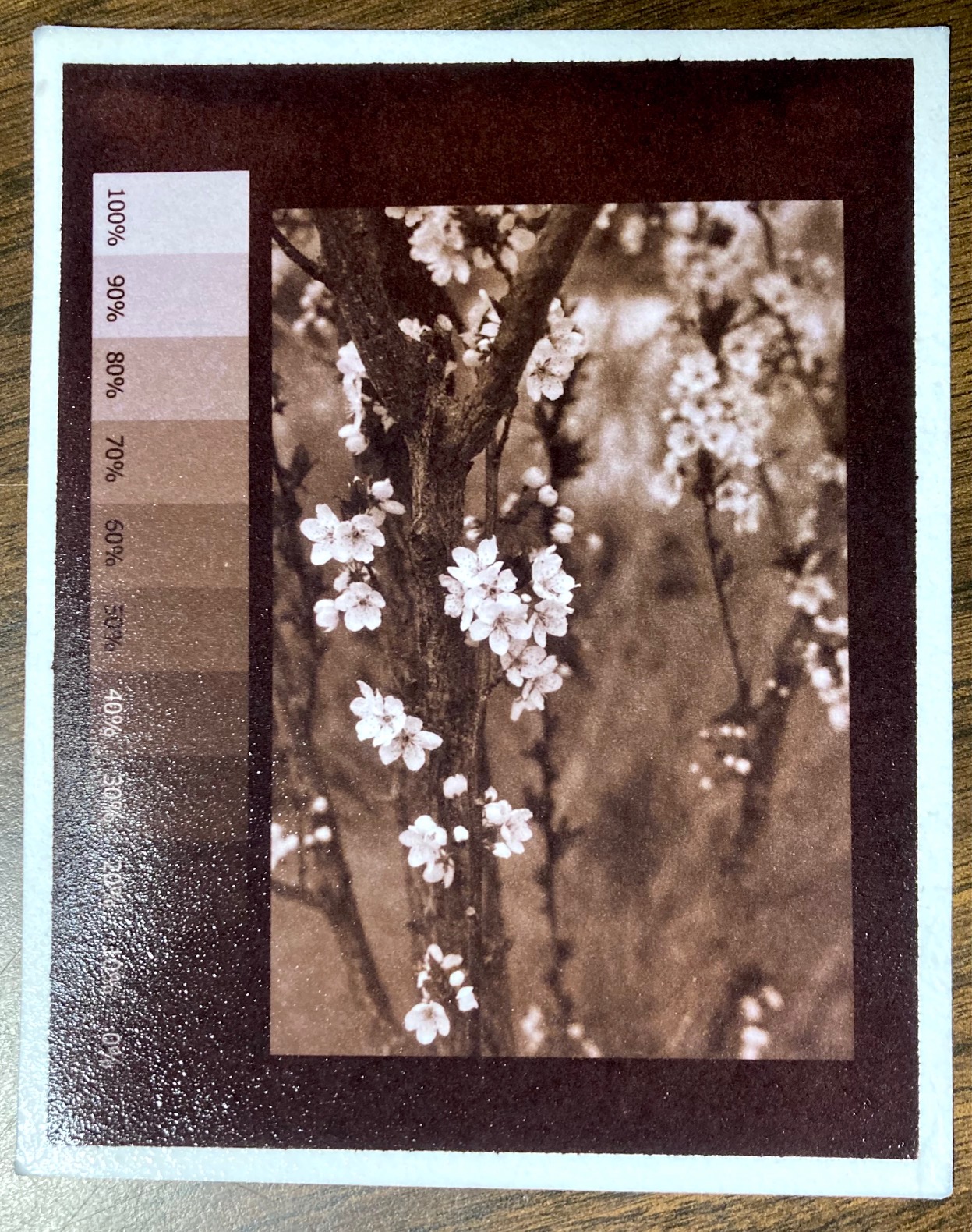

After a couple more sheets and a first test print using an actual negative, I have an update.
I did another test strip in 30 second intervals. It gets difficult to differentiate between tones at about 3 minutes and 30 seconds, although I felt that max dmax had been reached closer to 5 or 6 minutes. To see what kind of tonal range I had to work with, I printed a totally uncorrected negative (no curve applied) on Pictorico and printed it at 6 minutes. The attached picture is before it was dry, and it did dry down a bit.
Takeaways from this first attempt:
  • I got an acceptably good image! Took me 6 iterations to reach this point when I started with salt printing. Guess skipping all the "maybe this paper will work okay" steps and going straight to HPR was the right move.
  • Speaking of HPR, I'm impressed with this stuff. It looks and feels phenomenal. Went ahead and ordered a box of it from B&H, since the tiny sample pack I have is going to run out quick.
  • I like the color I get from my gold toner, and I'm glad I don't have any immediate need to experiement with anything else on that front.
  • It appears I'm roughly a stop shy of paper base white at maximum ink density. I also have shadows blocking up quite a ways before I hit fully transparent. Those things together indicate to me that I can probably get away with less exposure. When I get a chance, I'll try the same negative but expose it for 3 mins and 30 seconds to see if I can still get a proper dmax, while preserving paper base white in the highlights. If not, then I need to find a way to add more contrast. I may experiment with double coating the emulsion, or bite the bullet and introduce a little potassium dichromate into my sodium citrate developer. I was comfortable using chemistry that's pretty benign to the point, but I guess you're not a REAL alt process aficionado until you're screwing around with substances that will straight up kill you if you're not careful.
  • The step wedge in the image shows pretty clearly that I'm blocking up my shadows early. If shortening the exposure doesn't fix this all the way, it should be simple enough to tweak the curve.
  • There's something awesome about being able to use a wet printing process and get a good image from a digital capture. Feels like the whole wide world of printing has opened up now since I have a big portfolio of d-word images in addition to my physical negatives.
  • Having now tried several coatings with a puddle pusher and getting uneven results, I decided to use a brush for this. Went on easy and looks way better. Interesting, considering I went from a brush to a puddle pusher for the exact same reason with salt prints, and get better results with the puddle pusher there. I am using Tween 20 here and didn't use it for salt printing, so maybe that's the difference.
Thanks all for your help. I'm encouraged by what I'm seeing and excited to get this all dialed in the rest of the way so I can start making some larger prints for display.

That looks pretty darn good!
Such are the woes of digital negatives :wink:
Maybe reducing exposure will help, but frankly I don't think you're ever going to be able to use the full tone scale of the printing process with this inkjet printer. I recognize your findings (albeit not necessarily with kallitypes, but other processes). These are twofold: (1) dmax of the inkjet negative is generally insufficient to create pure paper white and still get dmax. (2) you need to apply a *very* steep curve shape in the shadows of the print (clear/light zone of the negative) to get good shadow separation.
Issue #1 is just what it is. Better inks, printers etc. can help. I didn't go that route, but it can be done.
Issue #2 is not really specific to digital negatives; you get the same effect with silver negatives, but digital negatives have the advantage that you can drastically improve shadow separation through digital curve corrections.
See if the reduced exposure makes a difference. I would certainly recommend exposing just enough to hit dmax and not a second longer to make the most of the tonal scale that the printer can manage.
Wait until you do the same with a large format sheet film negative :wink:
For processes that have an actual solution for a sensitizer, a brush is always preferable IMO. Perhaps with the exception of Pt/Pd due to sensitizer cost...
I'm using an Epson P800, and managed to get paper base white and dmax with salt printing after some experimentation. Since salt printing is supposed to require even higher contrast negatives than kallitypes, I remain cautiously optimistic that I'll be able to get the full tonal range the process can offer without spending any more on digital negs or equipment to make them. Especially since I haven't even started trying to play with any of the chemical contrast controls available for kallitypes.
Heh, I've been printing 4x5 for a few years. I still remember my first 8x10 silver gelatin print from a large format negative back in 2017. I had already been making enlargements from medium format and 35mm negs for years at that point, but was just absolutely stunned at the amount of detail in the print from the 4x5. Couldn't stop staring at it.

Ah that's right, well if you don't get paper white, then I'd make sure you don't have a chemical issue / fogging going on there. I agree that the density required to get pure white with salt prints should be enough for kallitypes. Provided you're hitting dmax with salt prints. I admit I'm still somewhat skeptical of the sufficiency of your p800 negatives, but it's difficult to accurately judge what's really going on over the internet.
BHuij
BHuij
Oct 12, 2016
962
Utah
You make a really good point - if I don't get to paper base white, I need to rule out fogging. I think I'll place a small piece of opaque paper on my next test image to see if it matches the unsensitized border to make absolutely sure.
It's entirely possible I wasn't getting dmax on my salt prints. But I got a dark tone that looked the same as the blackest areas in all my "test strips" from earlier on, where I was specifically looking for max black through film base. In any case, if for no other reason than convenience, the last steps I will take to get acceptable tonality here are ones where I have to mess around with my printer inks or drivers. Hopefully it doesn't become a necessary evil; it's such an unappealing part of the process to me haha. Maybe if we hit that point, then I've finally come up with a compelling reason to buy an 8x10 camera :wink:
koraks
Nov 29, 2018
27,484
Europe
I'm not sure if quad tone rip (QTR) still works with the P800, but it's worth trying - if you need to go there. Also the ink density settings in the Epson driver itself are fairly user-friendly. Between these two, you've got a lot of flexibility! Not quite as much as with film and developer, but still :wink:
