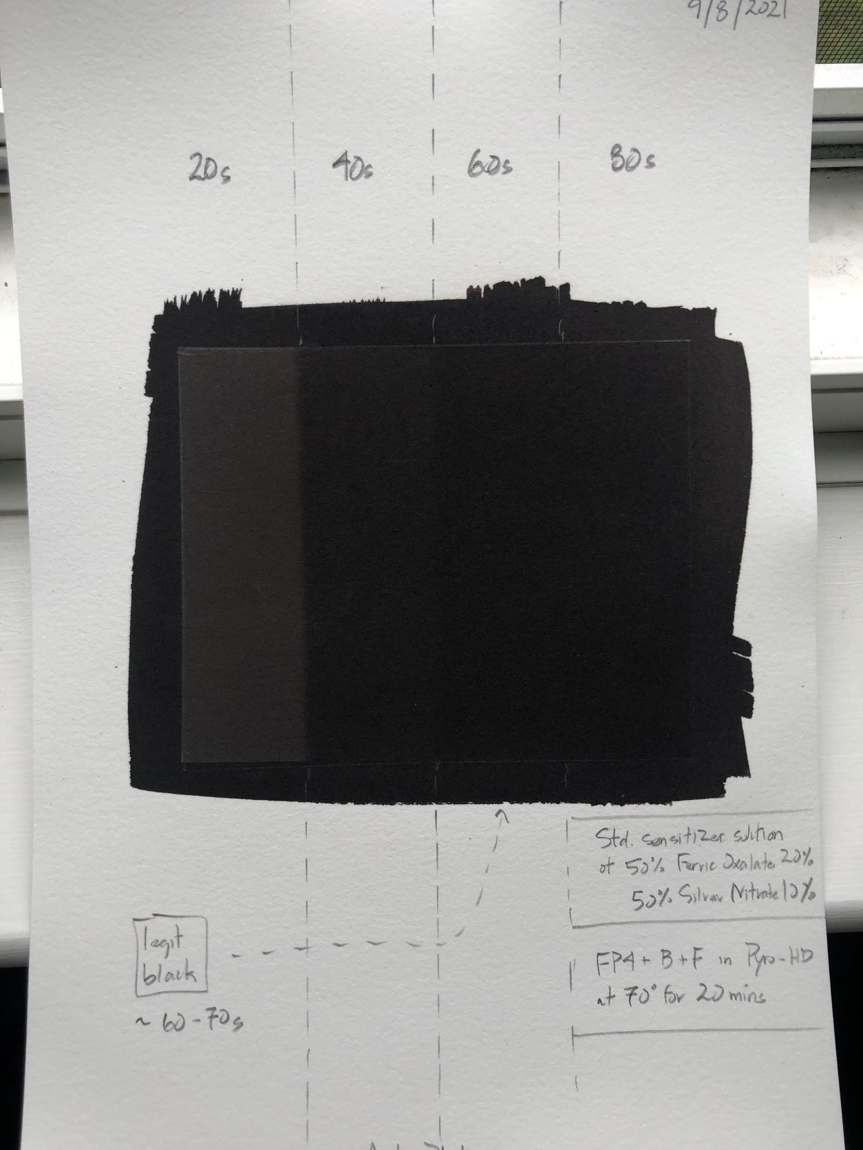

Because, to be clear, the max black/min time can be done with any processing time, correct? In other words, we are just checking when the film rebate (i.e. B+F) goes to black, and B+F should always be the same density (independent of processing time). Whether I developed a piece of FP4+ in Pyro-HD for 10 mins or 20 mins, I would expect the rebate to look the same.
So, perhaps process an unexposed piece of film and use that with my test strips to find min time? Then on to the ring?
I teach my students to do a min time max black for making 35mm film contacts on RC paper. Since there is some build up of B+F with the 20 min dev time compared to the 10 minute time (depending on film used), the resulting print would be a bit lighter if you used the min time for the 10 min developed film. You'll most likely have to do a min time/max black test for the 20 min developed film.
OK. 4x5 processed normally (other than for time) for 20 mins drying. Will report back as soon as I have more details. Thanks, Andrew. A million thanks.

Drydown is complete. Keep in mind that these are untoned and that I typically tone with platinum. Based on that, I am thinking that 70s is a pretty "correct" time for me (with 60s probably being equally fine). Thoughts?

I would go with 60 seconds. I wish my exposures were that short! Mine are 15 minutes for BLB exposure, when developed in sodium acetate, and 8 min developed in sodium citrate. My times are cut in half when I expose with 1000W halogen bulb. Gets too hot, though!
Yeah, I thought I knew what I was doing, but I have been way overcooking on time.
So, I think we say that, for as long as I am shooting FP4+ in Pyro-HD and printing on Arches Platine, my exposure time is 1 minute. Inclined to print the "ring" around a step-wedge in the center to get a better sense of which negative is giving the most range. Thoughts on that and, if so, which Stouffer stepwedge I need to grab?
