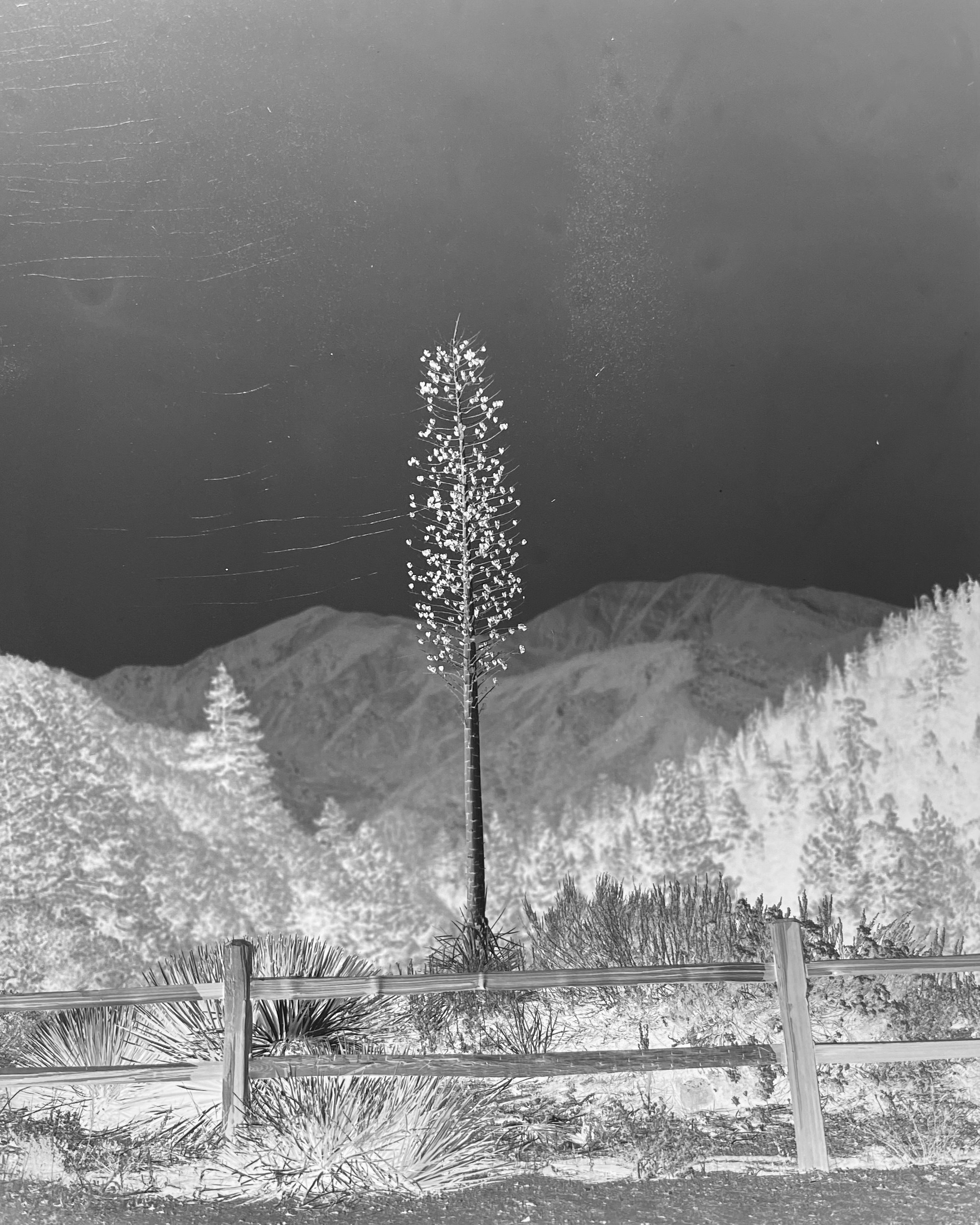

This is one of the better ones. I dried it like a champ by holding it in one corner and shaking

Here’s another that I left leaning against paper to dry

That's from dust settling on the film when loading in the holder. Go to the hardware store and buy some tac rags to wipe down your holders. Also buy a can of canned air and give the film a quick blast before closing the slide. Clean the inside of your camera. Lots of dust can gather inside the bellows. Lastly wipe down your film loading area with a clean, damp cloth. If the air is super dry where you are, consider a humidifier, or just plug in a kettle.

I'm not sure what the scratches are from though... could be from your tank system. Are you working in a darkroom or using a changing bag to load your film holders and developing tank? Changing bags can had a lot of dust and lint inside...

Thanks! It is very dry here. The scratches are mostly just the light in the photo though, those are barely visible in real life.

Not if the pinholes are perfectly round as is not the case here. Before we could actually see the negatives, OP described them as pinholes. First thing that comes to my mind is stop bath. If I'm not careful this can happen to me with HIE (I still have a few sheets left) and because of that possibility, I don't use an acid stop bath. It also has happened to me with Kodak Ektascan xray film.
