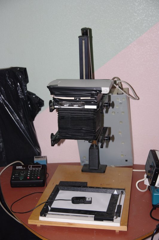

As availability of large format enlargers is next to nil over here, transport costs from Europe would be prohibitive etc, I decided to throw together my own.
Consists of kinda beaten Linhof Kardan Standard mounted to Meopta Opemus 5 base, Plaubel international back and Epson 1200 transparency lid as cold light source and some black tape :tongue: Holder made on plywood, need to make new for every format (9x12cm + 6x12cm in addition to 4x5).
Exposure is via shutter, no VC filters yet (no big deal as I print on graded paper usually).
In general appears to work, fighting with light leaks is a bit frustrating ofcourse. Aesthetically is not any beauty as well :smile:

The use of an Epson transparency scanner lid is an especially interesting idea.
Now that folks are nervous about the future of Aristo cold lights, your idea opens the door to a work-around.

Does the transparency lid provide enough light for enlargements? What are your exposure times?
For 2x enlargement (18x24cm paper) at f11 around 10 seconds on 20 years expired paper. Which is quite similar to time for the same paper using Meochrome head and 35mm film.
And this paper is slow, MCP was 2-3 times faster.

That's quite good, and I'm amazed. You've got something there!

'Amazed' is a bit understatement about my own feelings right now, after finishing first session. It's more like orgastic to see 6x12 negs on paper, even with only 2x enlargement :smile:
Now I need to find some fine lens for this Frankenlarger. Current one has front element from some 105mm Tessar and rear from Xenar with same focal length.
135mm Componon would be OK choice, I guess.

Can you show some more detailed pictures of your setup? Any problems with negative curling?
Really cool idea. There is no way I'm able find room for 4x5 enlarger in my house. Something similar should be easy if I make a system that replaces the back of my current camera.
