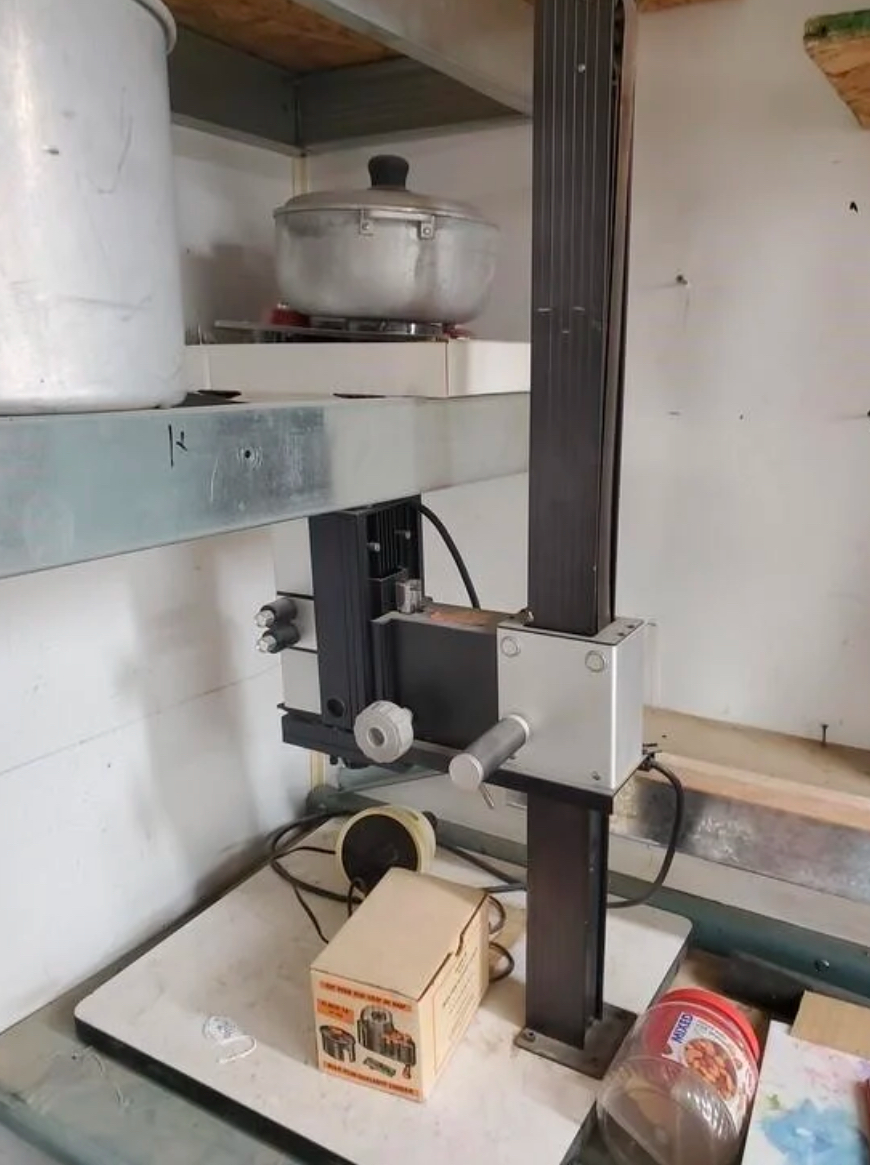

Anybody familiar with this? I won on an online bid for $12.

Does the bulk loader come with it?
That enlarger has a nice tall mast.
There does, however, appear to be some suspicious-looking sputum on the baseboard...

The original lamp for that is a MR16 base EKG which is 19V 80W. The power supply is regulated to 19v, though, one of my power supplies failed and was converted to half-wave rectified AC; no regulation. That works just fine for B&W.

Yes, just about everything on the Minolta is aluminum rather than plastic.
It is adjustable. The two circular things on the side of the housing that rides on the column are eccentrics for negative stage alignment. The lens board has its own alignment with grub screws.
I got mine in 1975 and still use it.

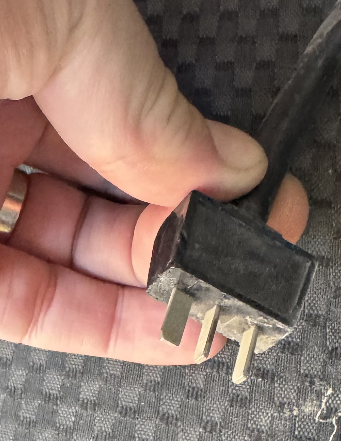

Just picked it up. No power supply I guess. Strange power plug
Lens is Nikkor. Is it a good lens?
Is it impossible to find the power supply?

Nothing special, a ground and two wires to the lamp (AC).
Something like a Hammond 185E20 might work (80W, 20V) about $40

I don't know the specs on the Minolta Power Supply, but you should be able to find them out, and if you can't find a Minolta power supply, you can make one -- and that might be cheaper. Yes, that's a different type of plug, but they do that to keep people from plugging it into household A/C -- which would "blow the thing up". There are lots of DIY ways to connect those plugs to whatever power supply you connect it to. One -- I'm not recommending this -- is to simply cut the plug off and connect the three bare wires.
I did the same thing for my Beseler Point Light Source. The Beseler power supply is even harder to find than the head, but I was able to find an appropriate AC/DC transformer from LIGHTECH for about $25. Then I used a standard, plastic, electrical box to house the transformer and the electrical wires to the standard darkroom timer.
