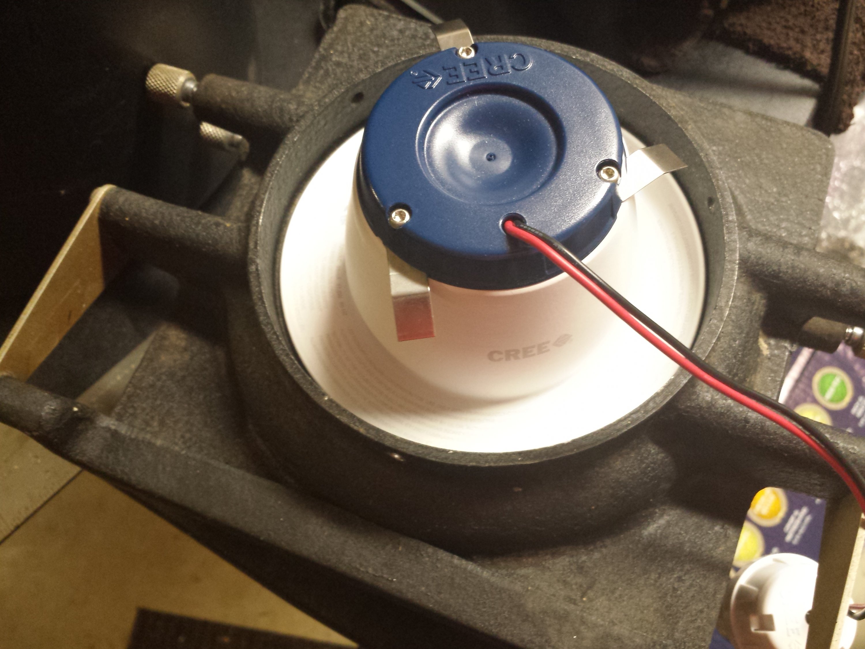

Also, a Cree 4 inch ceiling light drops right into the condenser head after you take off the lamphouse. No tools needed, fits right in, and is about 1 stop faster but 1 grade lower contrast than a 100W incandescent, and only 10W so no negative popping.
