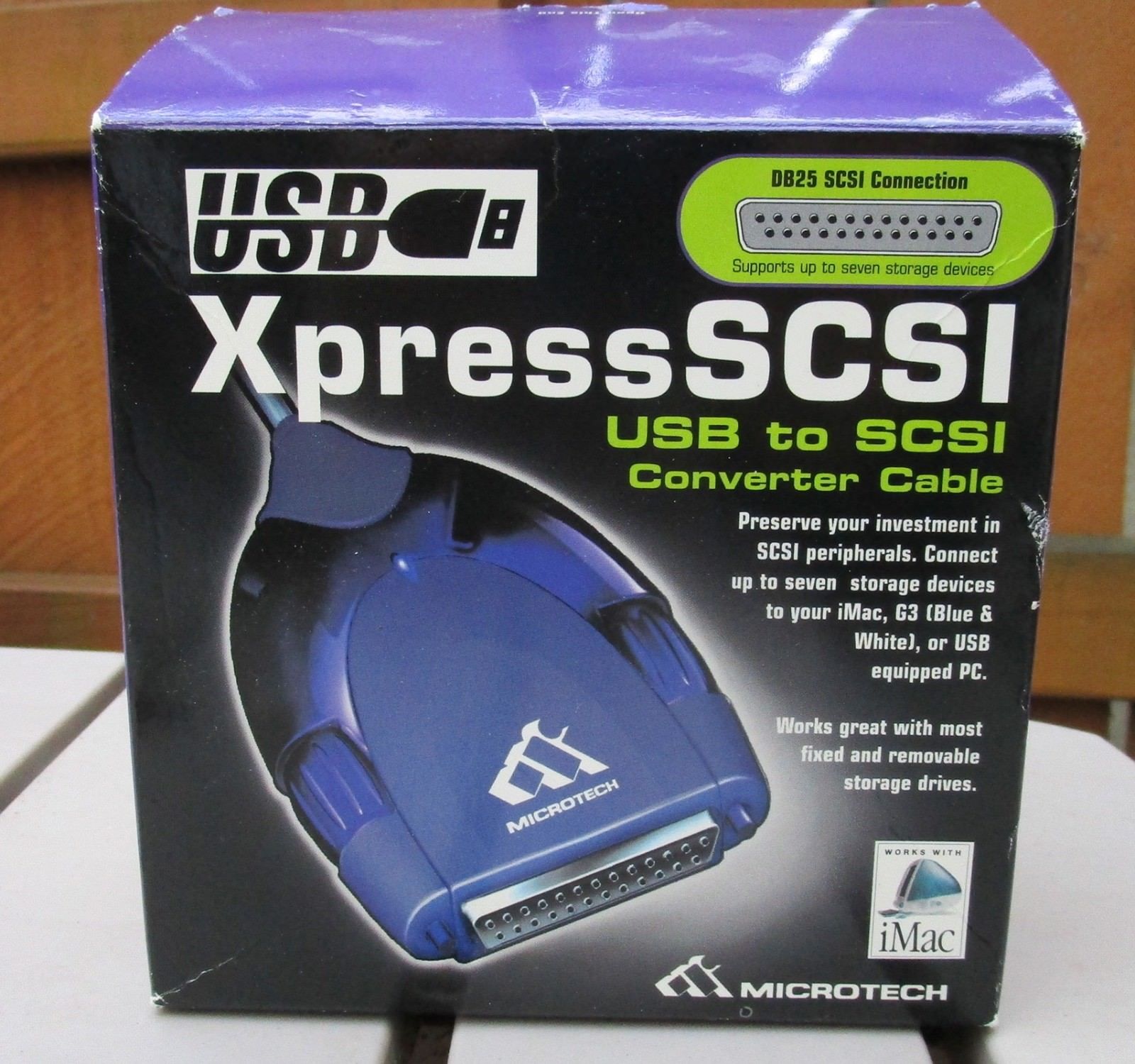

Frank, Can you post the link?
Lysander
Mar 6, 2018
11
Florida
Digital
