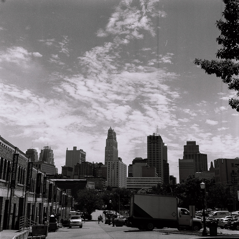

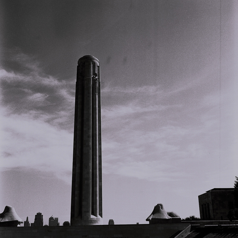

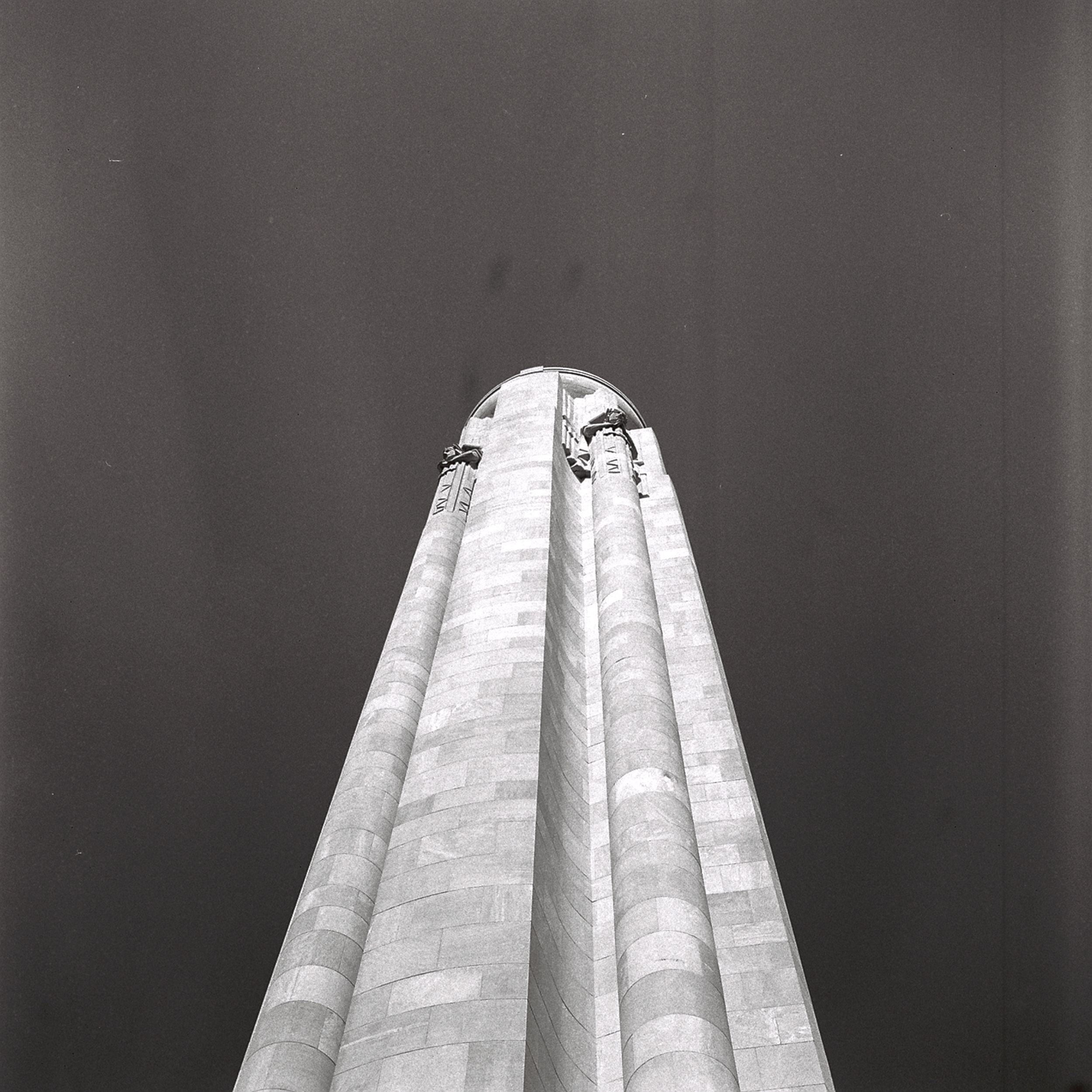

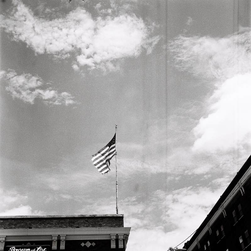

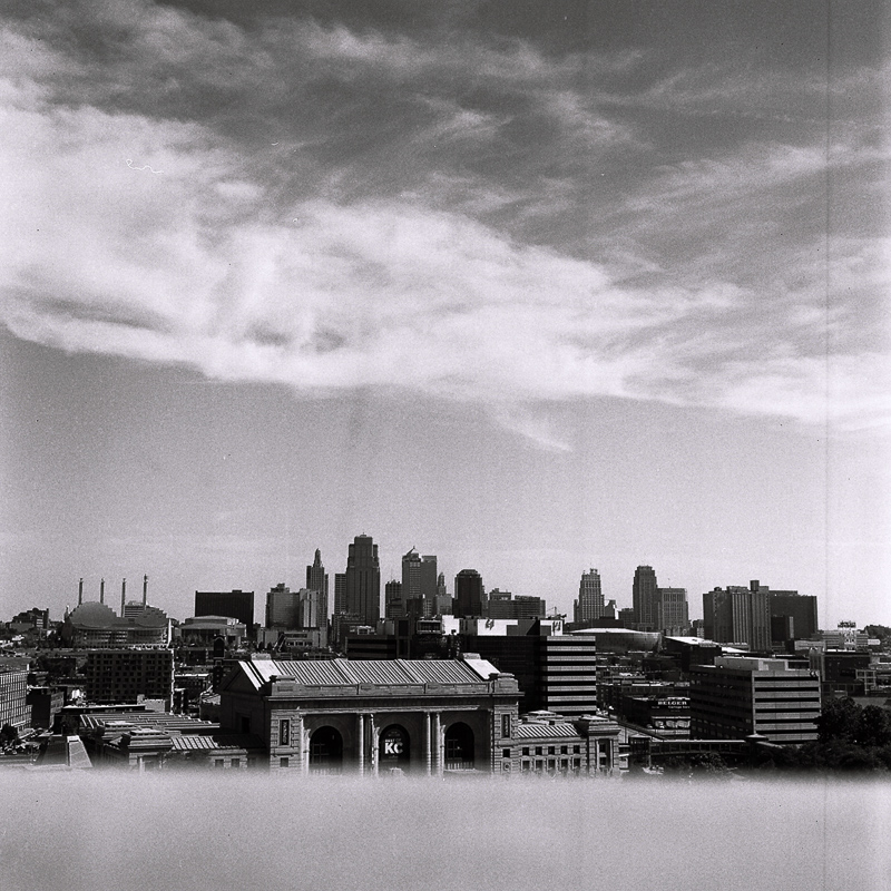

The Rollei is beautiful! The images are flawed. Shot 2 rolls, had them professionally developed and scanned. Both rolls have the same long thin black lines running up and down the right side and middle. Lab guy looked over the negs and they were fine. He checked out the camera and no issues. Took it to local camera repair that only works on film camera..saw no issues with the back or film advance.
I shot two rolls to make sure it was not just a bad roll of film. It is brand new film, TriX400
Its a Rolleilflex 3.5e Planar lens. Looks very clean. I cleaned the lens (both sides)...no effect and they look scratch free.
Any thoughts....I adjusted the contrast on the uploads to make the issue more noticeable
for review. Thoughts?

If the negs look fine, but the resulting scans show these artifacts, then it's a problem with scanning. The line on the right side could be a camera or film processing problem, but if they don't show on the negs then it's a scanning problem.
Overall, the other splotches and streaks appear to me to be a processing or scanning problem. The two black dots about 1/4 of the way from the top are unlikely to be a problem with the film or the camera.
I'd shoot another roll and try a different lab, or process them yourself.

In addition to the scratch, all of those photos have spots and streaks, and the spots and streaks are in the exact same places on each film. Looks like his scanner is dirty.

That doesn't look like a camera problem. I don't care how "high end" this guy is, have them processed somewhere else and see if they have the same problem. A filter or even a dirty lens isn't gonna make lines like that and neither is a leaf shutter. A rollei has rollers etc so it's not likely the camera doing this unless there was a very obvious problem with the film gate.

If you have a digital camera, do some cheap dirty scans of your own. Build a make-shift light table, photograph the negatives, and invert the image, convert to gray scale.
Those sure are wide and diffuse lines for camera scratches. Now the wavering in the lines does make me suspect the camera, but other artifacts in the scans point at bad scanning.Take a q-tip and rub around the interior of the camera, the rollers and see if it snags on something (lack of snags doesn't mean that it isn't from the camera, though).

Scratches in the film would be much more clearly defined, not soft and blurry as they appear in your images. There wouldn't be random "dots" in the images either, if it were scratches. I cannot think of ANY condition that would produce these results in-camera. That leaves the lab: either processing of the film (most likely) or introduced artifacts from the scanning.

I have a hard time imagining what in the camera could have created some of those marks, but long lines in the travel direction of the film (vertical lines if the film travels vertically) could be caused by something in the film transport. The best thing is to feel in the approximate location throughout the film pat to feel for grit. (Remember the lens projects the image upside down so that vertical line a few millimeters from the right edge of the image is actually on the left edge of the camera.)
While I wouldn’t 100% rule out the camera, it doesn’t really seem like it—especially the spots in the first few shots.
