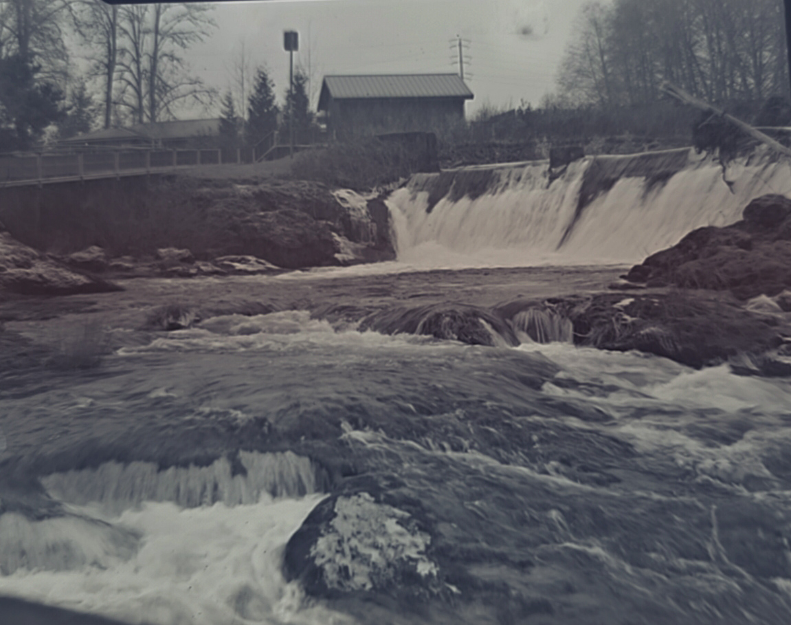

Well, shot my first 6 shots did some developing, had a wee bit of a screw up with the taco method so out of six shots there was one good looking negative. Here's to better devs next time! Thanks for all the help so far!
I got my best 4x5 development with the Jobo tanks. The rotational development uses the least amount of chemistry, which i otherwise huge.
You'll get the hang of it, but it doesn't usually come fast. It takes a while to learn bellows extension, each lens/shutter are a little different and developing technique has to fit your style. I have a physical handicap that doesn't let me do tray development. I tried the big FR twelve sheet tanks, Jobo tanks and processor and now the SP-445 tank. The Jobo CPP2 and tank was the best, but I sold it. The FR 12 sheet tank was ok, but the volume of developer used made me switch to replenishment developers. Then I bought a Stearman SP-445 tank and have stuck with that. The SP-445 is simple to use, uses very little chemistry and has given me very good, consistent results. You only do four sheets at a time, but that's just fine for my type of shooting. I very seldom shoot more than eight sheets on an outing and usually do some N or N- developing, so two short sessions works fine. I bought Leslie Stroebel's book "View Camera Technique" ,mentioned above, many years ago, and it really helps answer a lot of questions I had. Of course, that was before the age of computers and internet. Now you can post a question and have the answer in a matter of seconds. Now all you have to do is find out what works best for you and have fun doing it.

UncleJam
UncleJam
Jan 23, 2025
4
Tacoma Wa
Here's the results btw. I'll see about the sp645 tank as well. Thanks for all the help!
