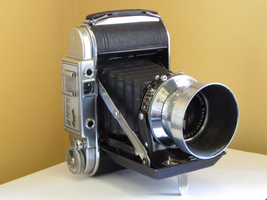

A bit of GAS I couldn't resist. Came with hood and filters, but was not functioning - Front element and shutter speed ring was jammed. Sorted that, replaced a spring on the door catch, adjusted the rangefinder slightly, cleaned the tiniest bit of fungus off the centre element (acetic acid - stop- did the trick). We'll see how the first film turns out.
I wanted a folder with a built in rangefinder, but wasn't willing to pay what super ikonta's go for and this came along. Seems pretty good quality. The lens is a schneider kreuzenach radionar 1:2.9 in a compur synchro. It's a cooke triplet.
