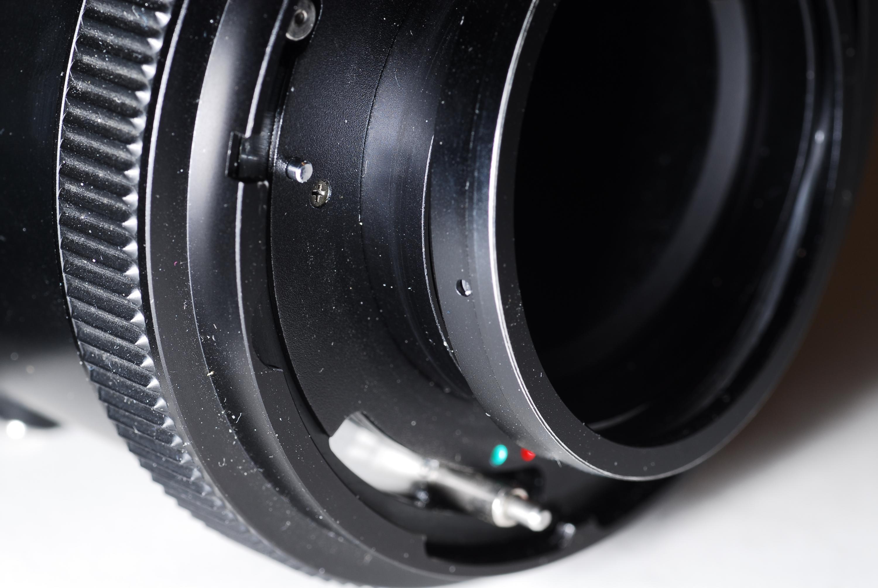

Hmm...now I'm getting confused about what the ring is. I thought it was a simple rubber ring, but that's not what is on the 180 K/L or the 90 K/L. All three look exactly the same at that end. The 180 and 90 slip on easily and turn smoothly. The macro is stiff to turn even when not on the body.

this photo shows the back of a 180 KL with the adapter ring slightly ajar;
The rings look like they're part of the lens, when they are in place, and they are not rubber, they are precision-machined metal. Twist it gently and lift to remove.
Also, SD tubes are only for the SD, and will not fit on the Pro-S. Not sure about using the ring when mounting various lenses on the SD extension tubes.

Ah, I see it now. I had no idea - I was looking for a rubber ring. I really appreciate your taking time to enlighten me, Jeff. Much appreciated. I think I'm good to go now.
