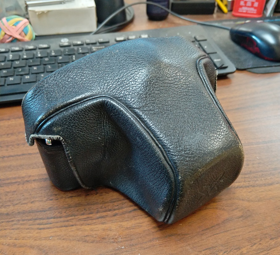

I read that the Ricoh Singlex TLS version is mostly aluminum castings, but this one is a lot of brass and cast aluminum. It's pretty hefty.
