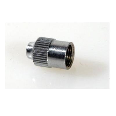

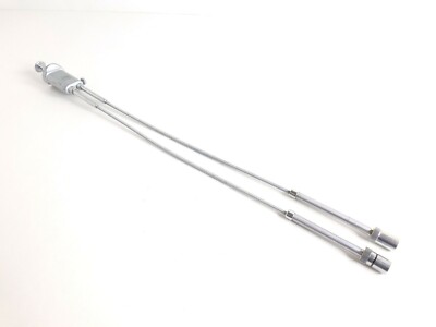

I'm going to need a Leica nipple, and I don't like the prices I see on Ebay. Is there any way to remotely trigger the camera without using one of these overpriced fittings?
Dan Daniel
Jul 4, 2009
3,071
upstate New York
Who knows how high it will go.
Just cut off the second one :smile: I bet having the word 'Leica' in the description adds $30 to any price!
Simple but not as cheap as I remember.
