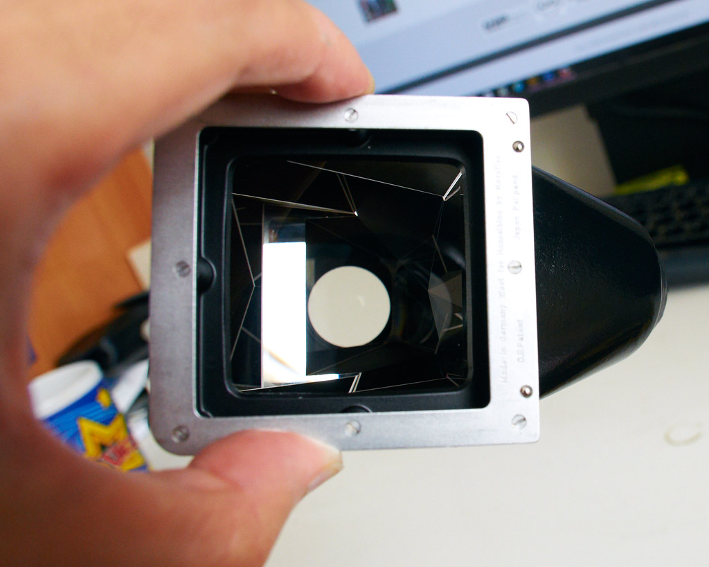

Just got it about 30 minutes ago. The optic and the mirror are flawless with couple of specks. That's about it. No scratches or separations. The paint can be retouched or even repainted. Just need a rubber eye cup for it since I wear glasses.

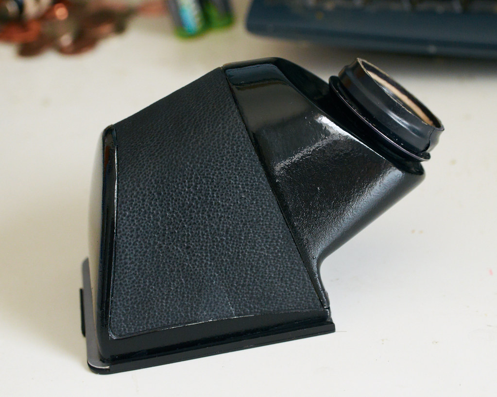

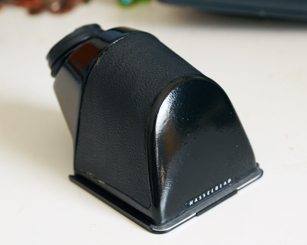

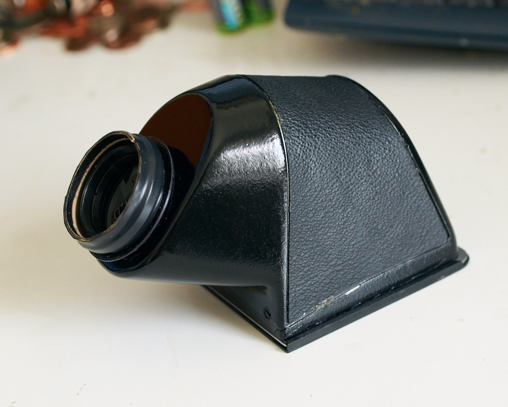

The prism is clean. I mean CLEAN. :smile: I did remove the rear part of the prism housing and to wipe down the underside of the viewfinder optic. It has some light haze. And the prism was manufactured in 1974, date has been stamped inside the prism. The brown part could be from the reflection of something. The viewfinder optic has some dust and grit around the edges. I cleaned that up with some rubbing alcohol. Few hours ago I light sanded the paint off and to strip it down to its grayish paint base. Then, I spray painted two coats of gloss black paint. Waiting to dry right now. The NC2 definitely improved the way I shoot with my 553 elx. It did add another pound to the kit. Is just better than using the waist level finder alone. And I could see the entire frame too AND can focus using the center prism on the focusing screen. Before with the waist level finder, is either/or. You need the magnifier to focus but it won't let you see the entire frame. If you want to see the entire frame, you have to flip down the magnifier.

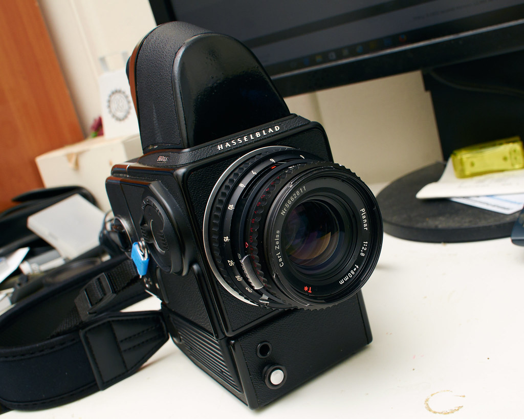

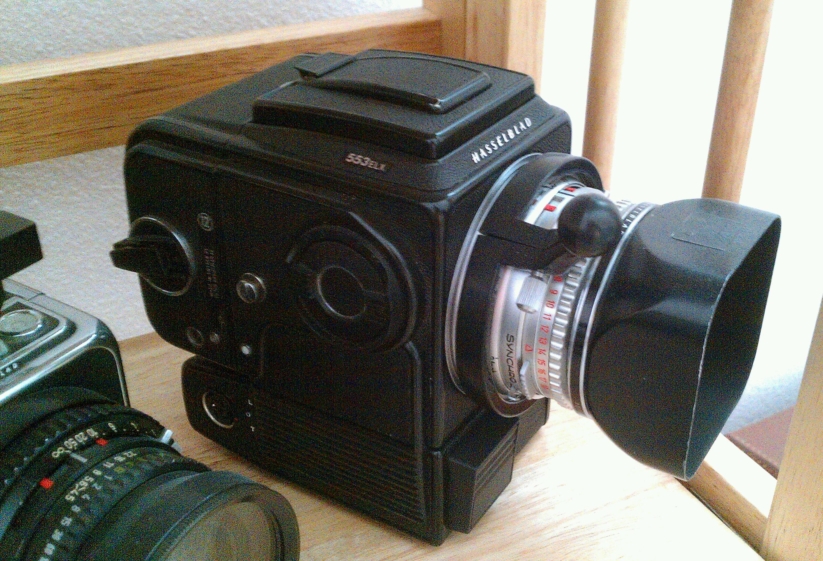

Here are some photos...I am not pro when comes to paint job. Is better than before.

For the eye cup issue, I used a large rubber band (something rubber I could find). And to cut it to fit around the viewfinder circle. There is an outer ring slightly larger than the actual viewfinder. In between these 2 pieces, there is a slot. I just fit the cut out rubber band into the slot. Then, I wrap around some black electric tape around it.

I use the rubber eyecups from the Kiev meter prism.
Not easy to find but fit like they were made for the NC-2's

You might also like the rapid focusing handle; it makes focusing those old C lenses so much easier and enjoyable:
BTW, nice job with the paint!
