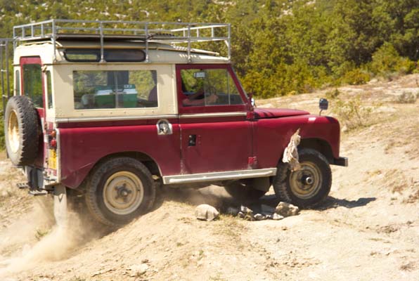

Yup. Last week I'd backed out of a REALLy difficult road; reversed across a hump; and...
That's despite nearly 30 years of driving Land Rovers.
