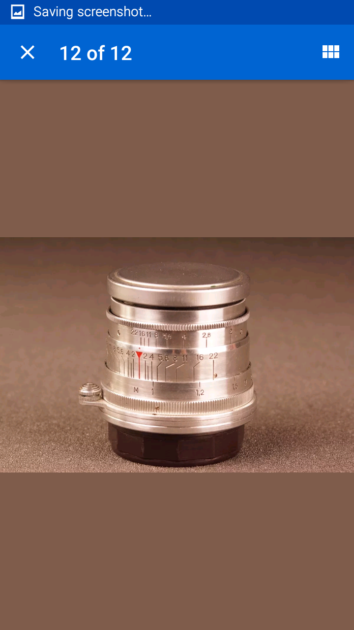

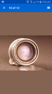

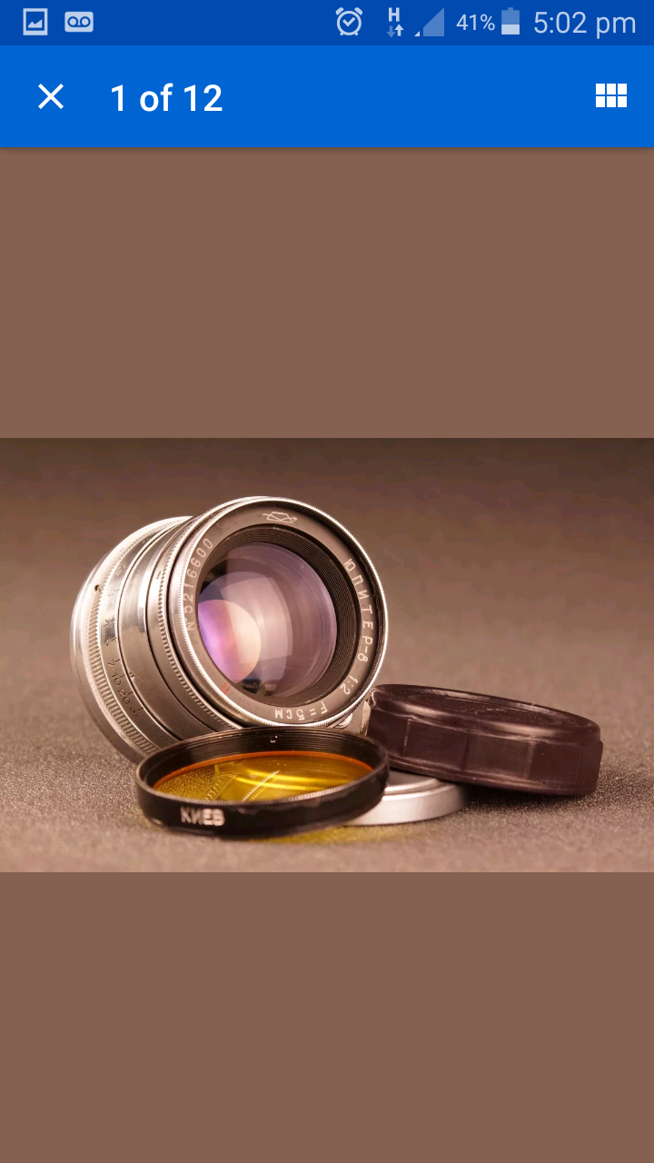

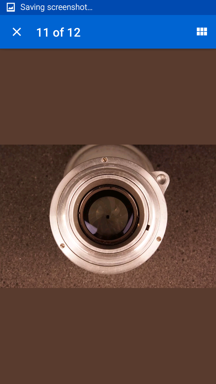

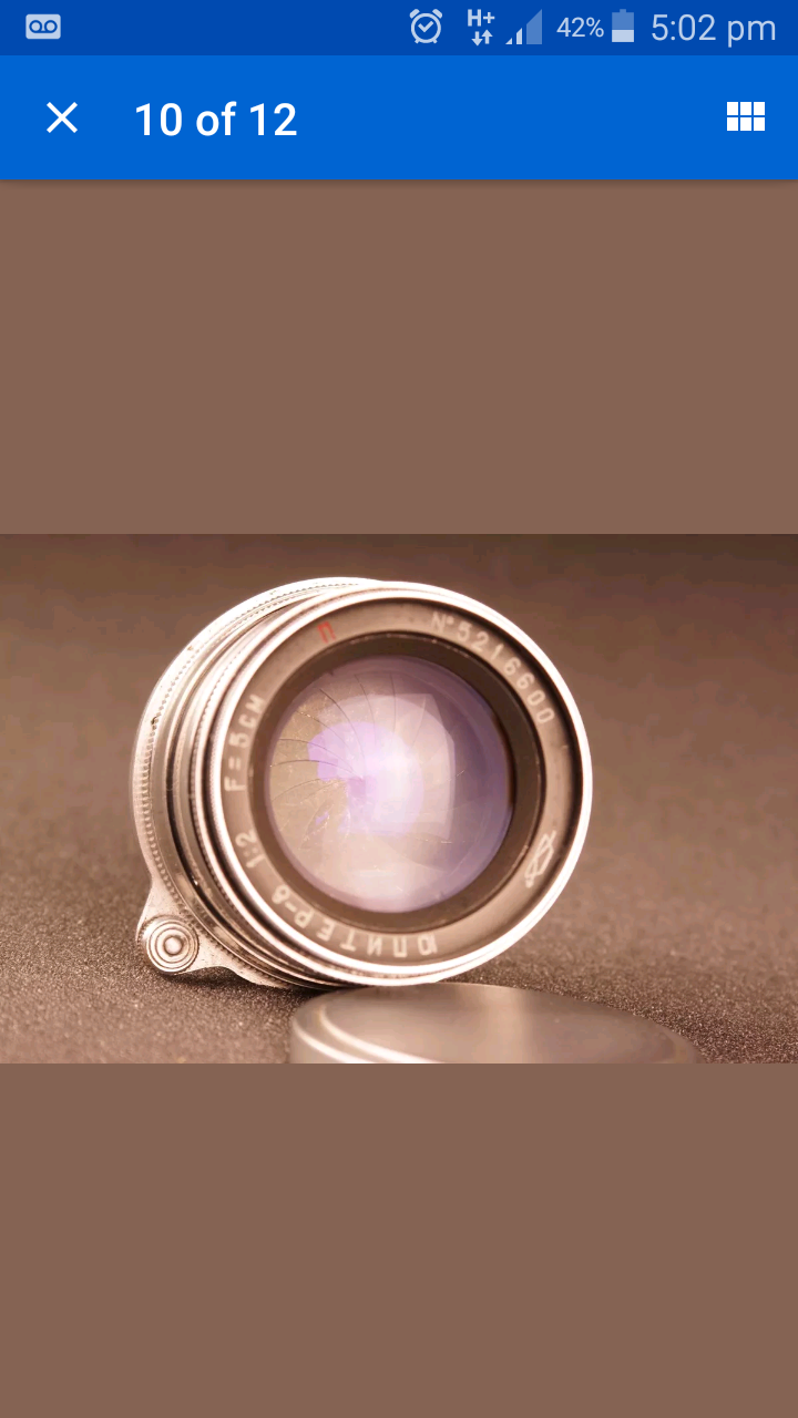

Just won a chrome 50's Jupiter 8, but it has 18 aperture blades rather than the typical 9.
Can't find a thing on th'internet about it.
Ideas? Opinions? Conspiracy theories?
What do you think the quality will be like?

Sounds weird, almost like some kind of hybrid, but it may be some kind of special edition.
Send Brian a message over at leicaplace.com here: Dead Link Removed
If anyone knows, it must be him, he has seen hundreds of these and should know a lot.
I suppose the out of focus highlights will be pretty round :tongue:
I would be interested to see what you find out about this lens ^^

The only other lens I know (soviet) with 18 blades, is the Jupiter-6 180mm f2.8, it's huge, but if the aperture is way back in the lens, it's perhaps possible to hack something into the Jupiter-8
https://c1.staticflickr.com/8/7098/7163292012_357e4404c8.jpg
Again, I would recommend Brian, he has not only done a lot of work on a lot of lenses, but he has also created various hybrids from one mount to another etc and should know. (I am 100% sure he will be intrigued to know more about the lens ).

This was the most helpful reply I've had from an engineer called Brian.
"The focus mount is from 1955 through 1960 or so: the earlier tabbed J-8 mounts did not use the three screws for the rear.
The 1952 SN: most likely Zeiss Glass, Zeiss barrel, finished in Russia. I have some "assembly practice" lenses from this period that have a one-off quality, like they were experimenting with making them on their own. Think of lots of parts and optics coming in from Germany after the war and then reverse engineering them. Ultimately: the Russian fixtures were better, but it took some time. I have some 1950 lenses that never worked, someone much later put them into a focus mount- to use them (those generally worked) or to sell them.
If the images are good agreement with the RF: you should get some really good pictures with it"

The 1952 SN: most likely Zeiss Glass, Zeiss barrel, finished in Russia...
Not likely at all. Here is no repatriated German glass in J-8 at all. J-8 is original FSU lens with glass recalculated from CZJ Sonnar.
