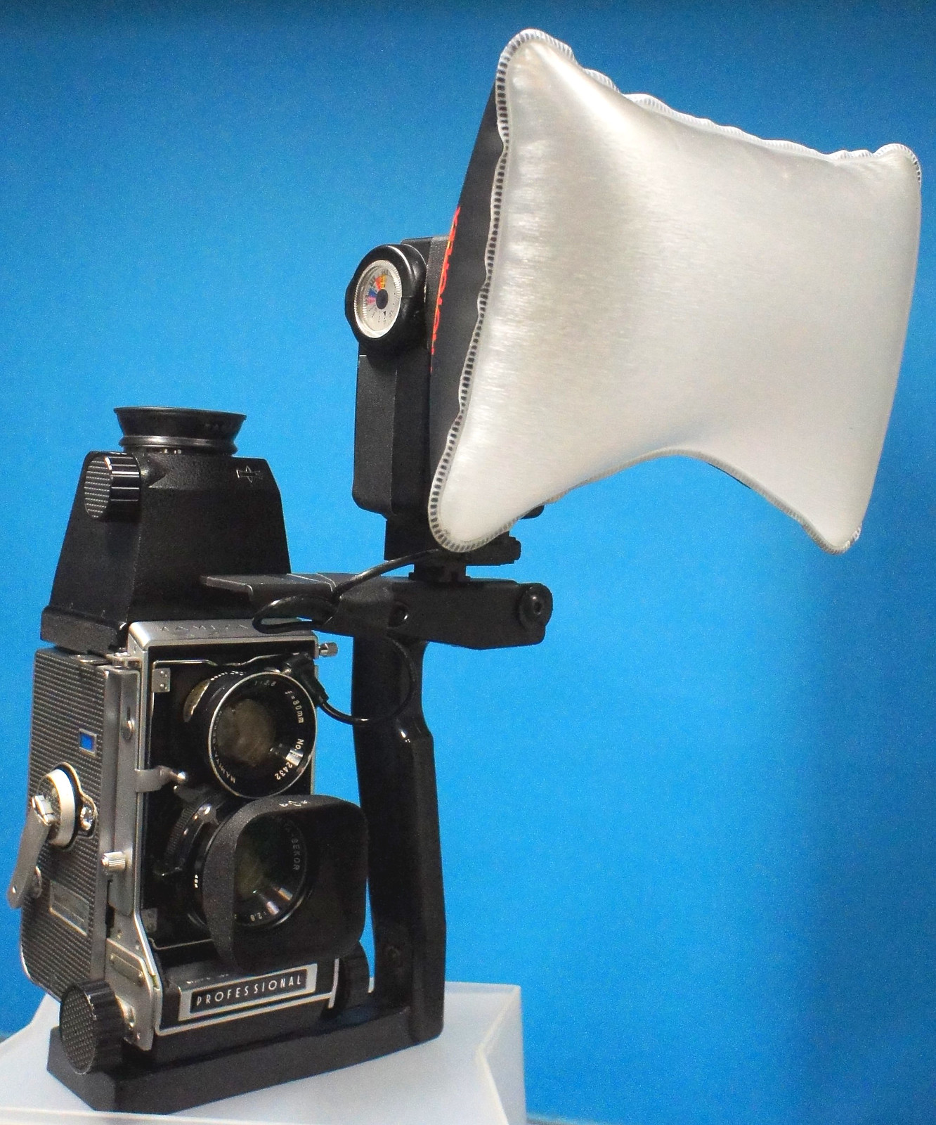

C33 80mm 283 My Old Wedding Camera by Nokton48, on Flickr
  • Here I have put together my old wedding camera. I carried two of these, one in each hand. That would give me 48 shots without stopping. Great for all kinds of situations. Bullet proof. Kids would approach and want to squeeze the "beach ball". LOL
BTW that's a Bacharach Bracket the precursor of the Stroboframe. I have ten or twelve of the Stroboframes, each with Quantum Bantam and Radio Slaves. Neat and compact.
