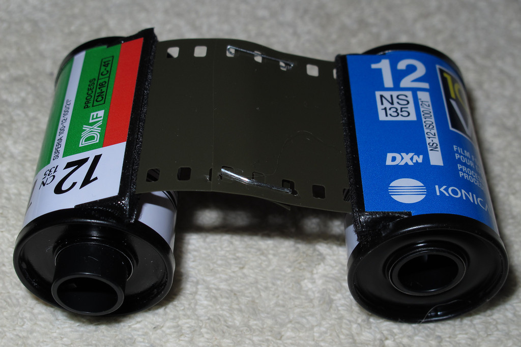

A while ago I asked what folks do when they have, say, a 36 exp roll, a 24 exp roll, and a 12 exp roll ready to process, but have only a two-reel tank. I'm not sure what replies there were but I eventually came up with my own solution that I've been using for a while now, and it works great. Staples!
The trick here is to leave the leaders out when you rewind, or extract them with a handy-dandy lead retrieval tool. This allows me to join a couple 12's or a 12 and a 24 and still have a spare reel for loading another roll. They wind fine onto my Patterson plastic reels; not sure how well this technique would work with steel reels.

Tape works well too for 120. You should staple maybe after you have an end on a roll and in the center as the plastic reels have ball bearings for sprocket holes.
Mike Wilde
Aug 10, 2006
2,903
Misissauaga
If you can talk a photo finisher into selling you a short roll of Blue Max film splicig tape you will be in heaven. My full roll cost $20, and it is several life times supplies. Its adhesive sticks well to film base, and to almost nothing else. It is waterproof, and stays in place thorough processing solutions too.
I addition to using it to load bulk load film to the cassette spool, I use it to join 120 films end to end to load on a Paterson reel when I am processing c-41 or E-6, and want to minimize the number of re-uses of the chems through the tank, where they get aerial oxidiation, while processing the rated numbers of films
