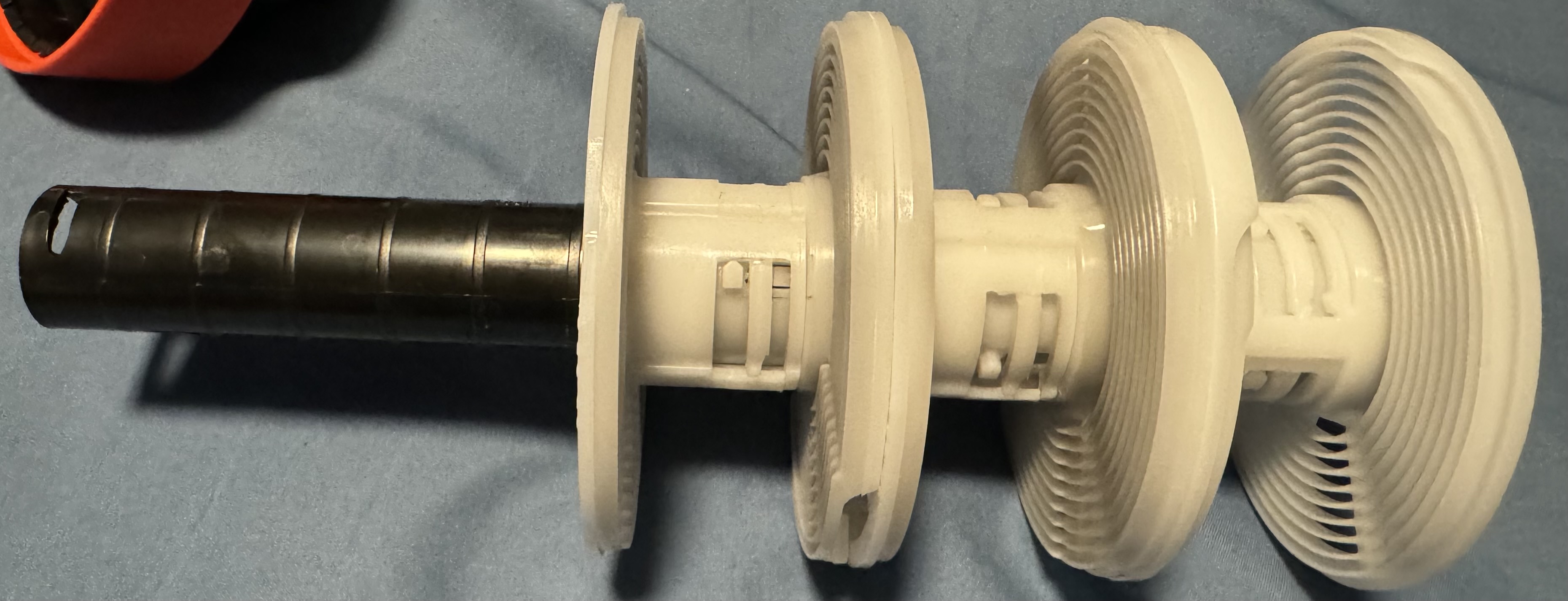

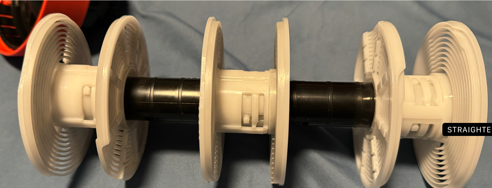

How would you setup the reels for Xtol 1:1
  • Separated
    Votes: 0 0.0%
  • Total voters
Radost
Jan 21, 2021
1,659
USA from Ukraine
How would you setup your reels for 1:1 inside jobo?
Together 1 or separated 2?

Load the reels as usual and place empty reels to take up the remaining space.
So do I. The full reels are at the bottom for XTOL, XTOL 1:1 and replenished XTOL.
