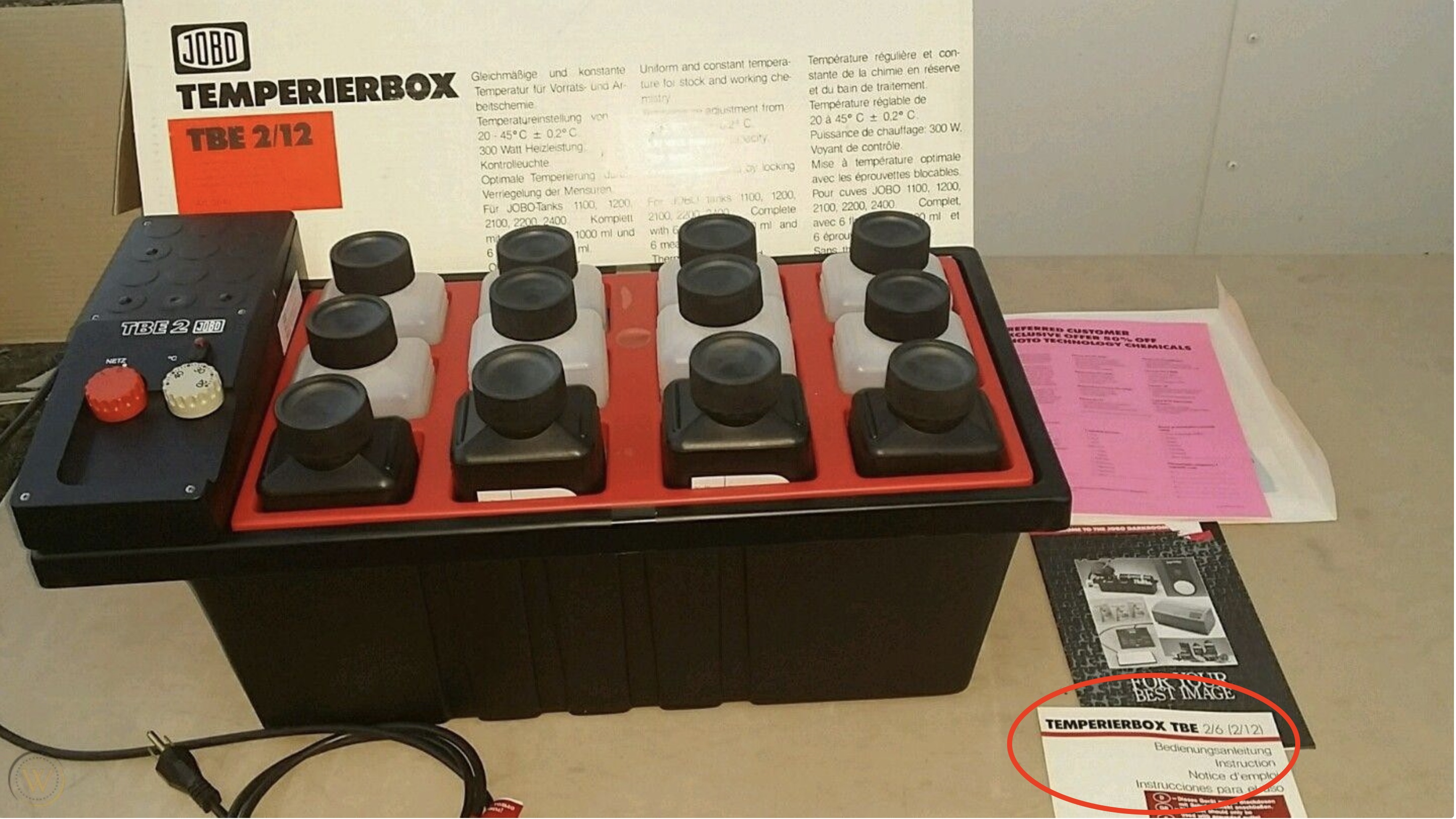

The only pdf manual I have is for the older TBE (not TBE-2) shown here. The actual TBE-2 manual (seen in the e-bay screen shot) may not exist in pdf form. Somewhere in a Jobo document I read to only fill it half way and if it won't heat, check the thermal cutout switch.

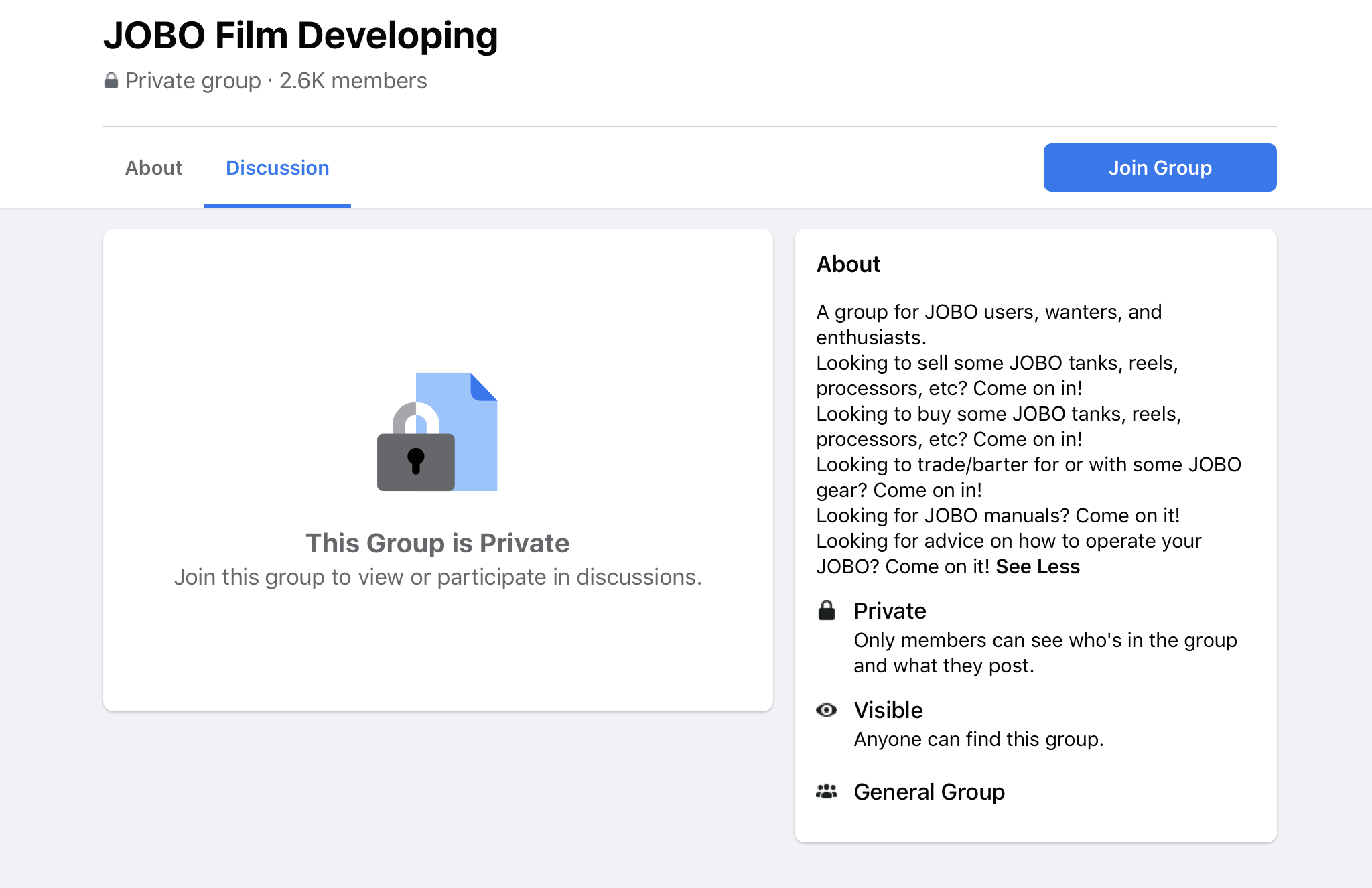

The TBE 2 manual is available in the files section of the Jobo Film developing group on Facebook. It's the same one that's circled in the picture in post #4.
ic-racer
Feb 25, 2007
16,728
USA
I don't see any links to files.
