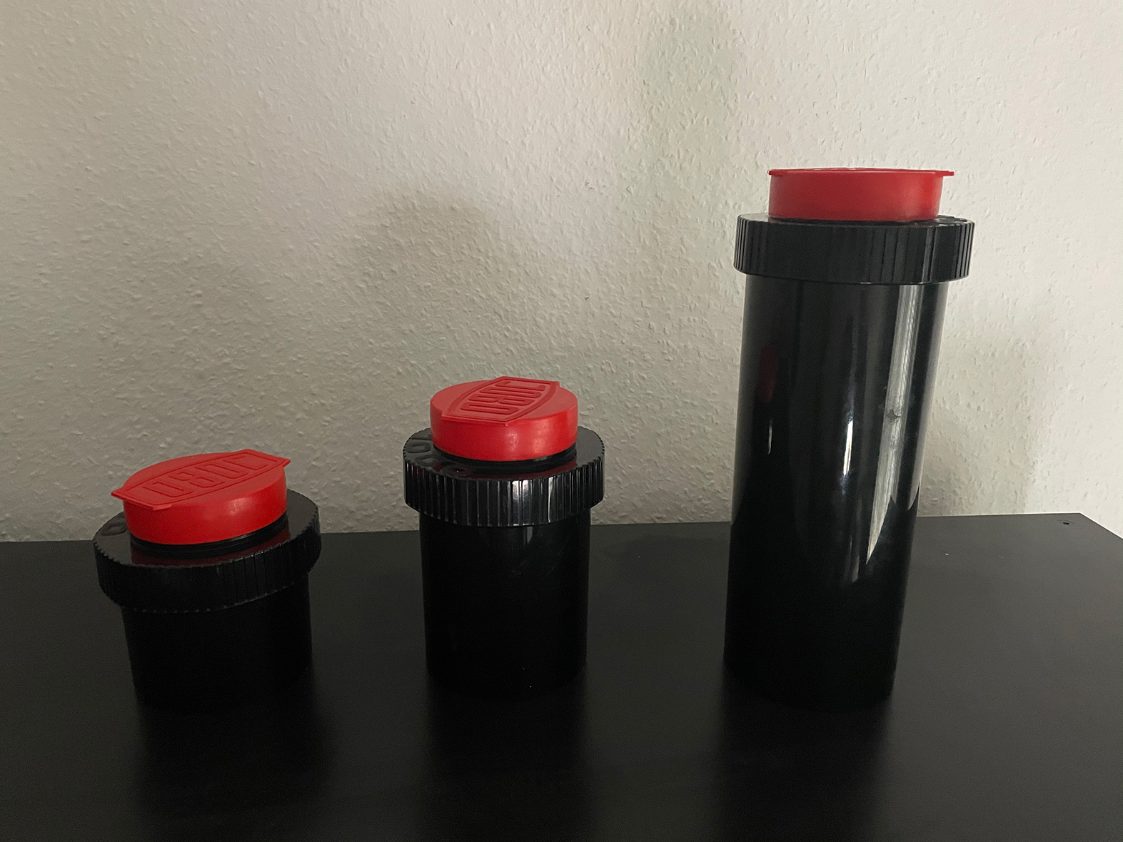

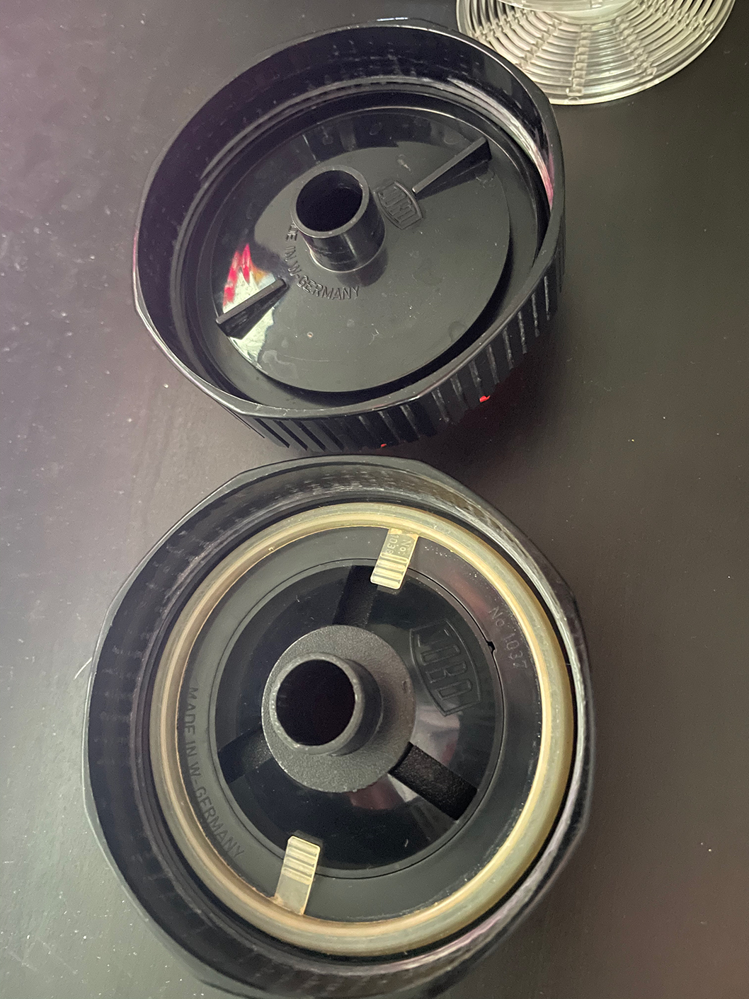

Hello I recently acquired 3 Jobo tanks because I think the reels are much better than the paterson ones, loading is such a breeze now. Today the Big tank arrived (see in spoiler) and the cap has a seal. Is the sealing missing on the other 2 Tanks or did they came out of the factory without a seal?

-all Series 1000 tanks I got (identical to yours in cap serration) got no extra seal
-) all Series 2000 tanks I got (though with different cap serration than yours and the 1st Series 2000 tanks) got no extra seal
All these tanks without extra seal got screw-in funnel inserts with two ridges as grips. The sealing takes place by the funnel insert having got a slightly conical circular ridge going into the tank circumference.
However I got two tanks of different diameter of the period preceeding the Series 1000/2000:
-) the Series 1000 equivalent has got a funnel insert glued into the cap, that got a sealing ridge as above
-) the Series 2000 equivilant has got a funnel insert glued into the cap that got a circular recess into which a PE-seal ring is inserted, exactly as with yours.
Seemingly this early design was taken over into early versions of the Series 1000 (2000?)
Looking further at reel deails of the pre Series 1000/2000 tanks even more differences in design among themselves show up. Thus quite a mess concernung sorting things out...
Thus nothing is lacking at your tanks, you just got two different versions within same series. I guess the tanks proper are all the same, so that you may exchange the caps.
Thus nothing is lacking at your tanks, you just got two different versions within same series. I guess the tanks proper are all the same so that you may exchange the caps.
Thanks, I was just wondering because it seemed strange. The screw funnel fits on the two smaller versions as well so if one is leaking I guess I will use the cap with the seal.
