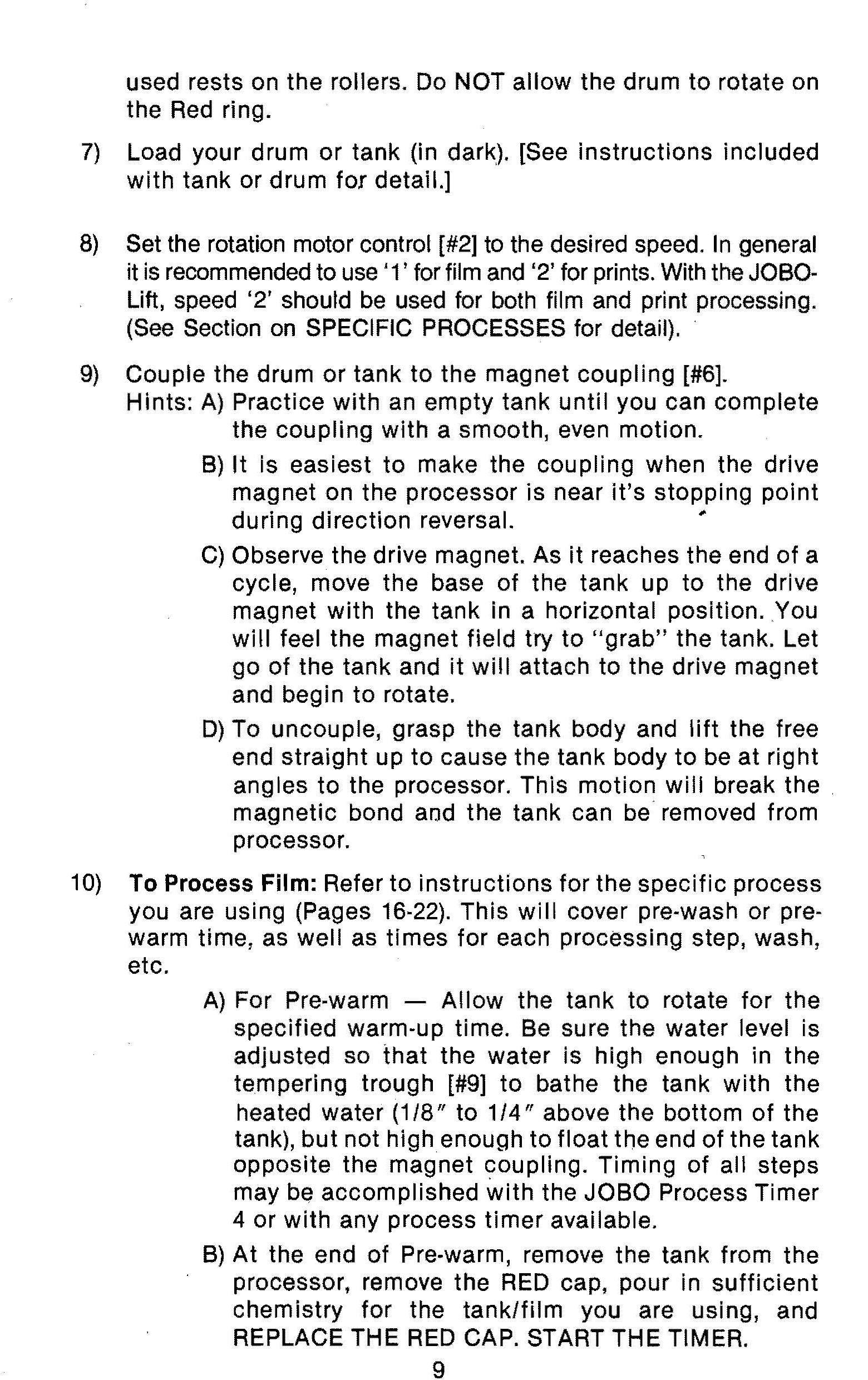

I own different versions of CPE2, CPA and CPP. The CPE2 manual clearly states that the slower speed 1 is for film and higher speed 2 is for print. At the end of the CPE2 manual, it lists all processing tips for different processes. For C-41, use speed 1, for RA-4, use speed 4. If you use speed 2 to process film, you'll have to shorten procesing time. The CPE2+ has just one speed. So the film processing time should be shortened.
I believe the CPP2 instruction has similar instruction.
So film=slow speed. Print=fast speed.
See part of the CPE2 Instruction:
The manual says speed 1 for film and 2 for print, but 2 for everything if you have a lift. Either way Jobo manuals have been revised many times over the years, and in any case eventually Jobo gave up on the two speed thing for the CPE system with the use of just one speed, which is closed to speed 2 of the older CPE... The bottom line is that there is such a marginal difference if any between the two speeds when processing film i think it does not really matter.
