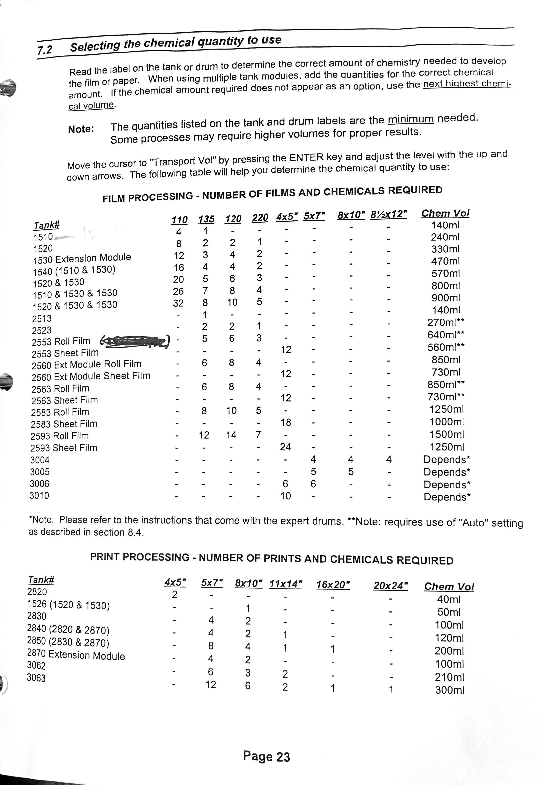

Jobo naming is a kinda cryptic, and the product line changes over time, so I am a bit lost. I want to process 30x40 prints. Which Jobos can handle those? I am fine with just one sheet. Looks like Jobodrum 4551 + format holder 4512 will do, 2840 also would.. are there other options?

Here's a page from my Jobo ATL 2200 that shows tanks and reels of the time of publication. This is not included in the download manuals from Jobo USA anymore; hope it helps some.
Click on image to enlarge; right-click on enlarged image to save. Print drums are on bottom of page.
I have the 2840 and it fits on the ATL 2200, if that helps...
