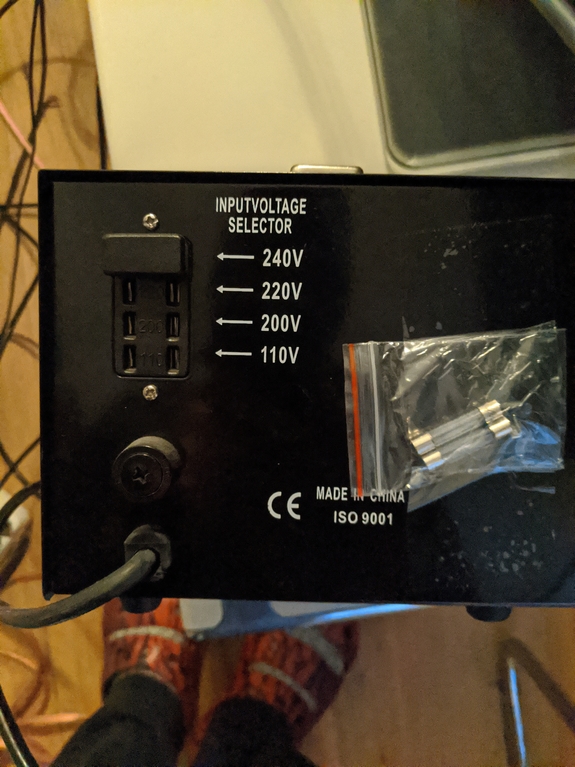

I need some help, just recieved an old LPL enlarger w out power supply, I have sourced a new one at 500€+, any ideas on what I can use as alternative to buying a new one, I'm in Germany w 220 electric. Thx for any help
Germany years ago changed to 230V.
(The original power supply thus would not have been the optimum solution anyway.)
Hallo Jerevan, you mentioned using a Kinderman 707 power supply w the Jobo LPL 7700, I was so happy to find one on eBay, got it today and low and behold it only accepts two prong plug from the enlarger, my Jobo has a cord three prong plug what to do now? Can I simply splice a two prong on to my Jobo cord, and where might I find this...any help or advice appreciatedHallo Jerevan, you mentioned using a Kinderman 707 power supply w the Jobo LPL 7700, I was so happy to find one on eBay, got it today and low and behold it only accepts two prong plug from the enlarger, my Jobo has a cord three prong plug what to do now? Can I simply splice a two prong on to my Jobo cord, and where might I find this...any help or advice appreciated
230V AC - 12V AC 100W transformers were common for interior lighting when halogen lamps were still in fashion.
One may also consider a switching power supply for same use.
