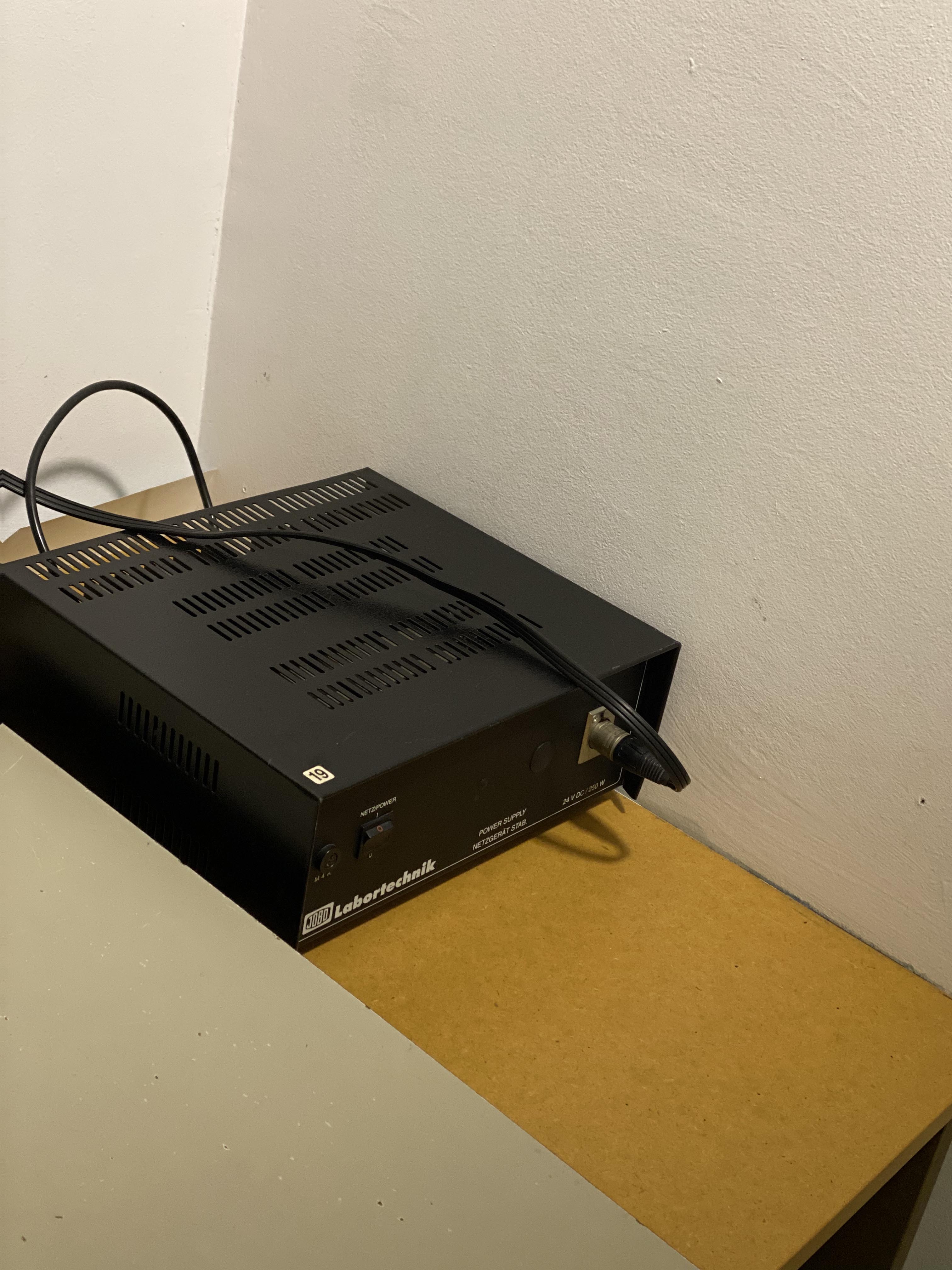

Hi everyone!

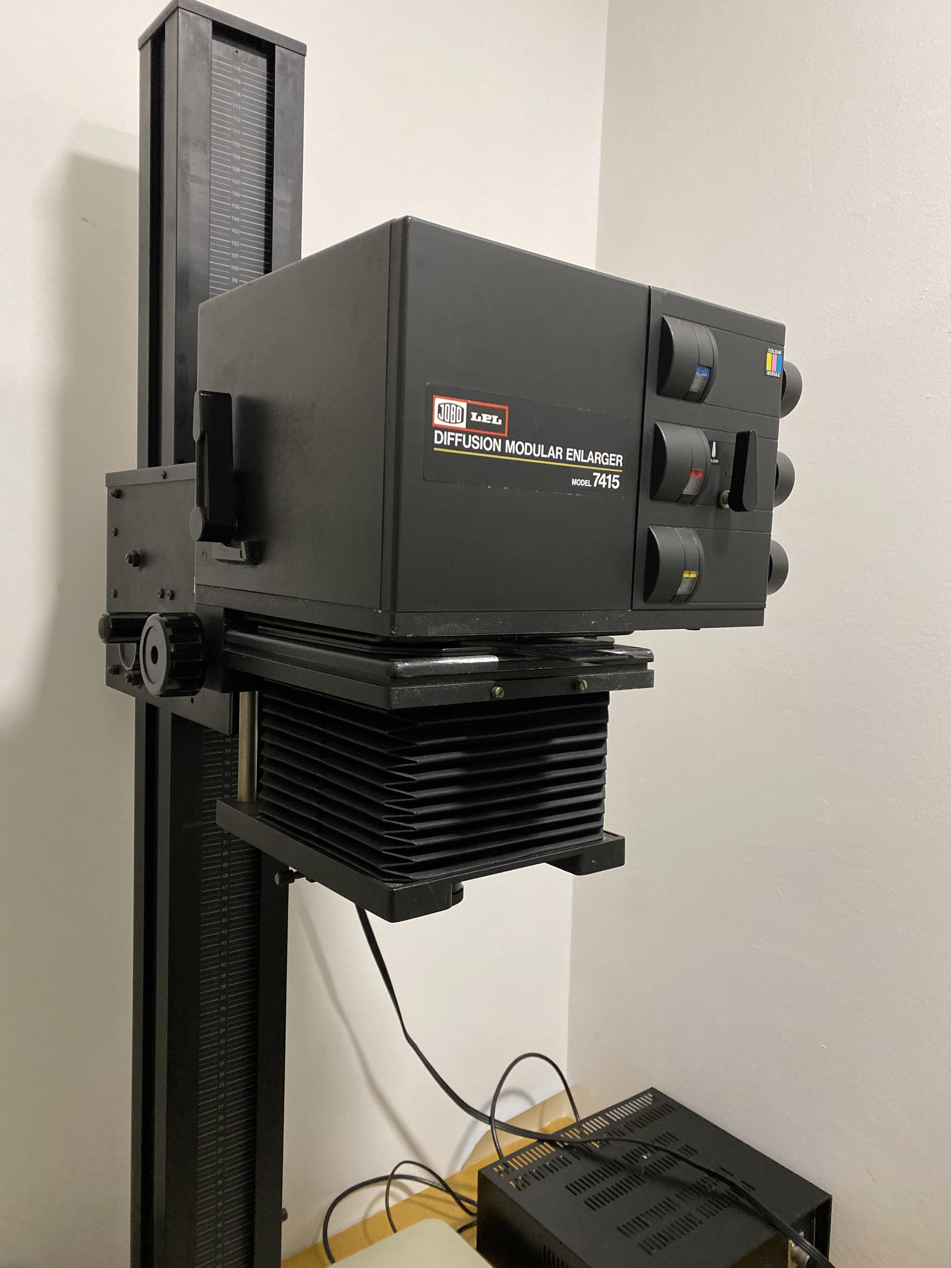

I'm having some problems using the Jobo LPL 7415.

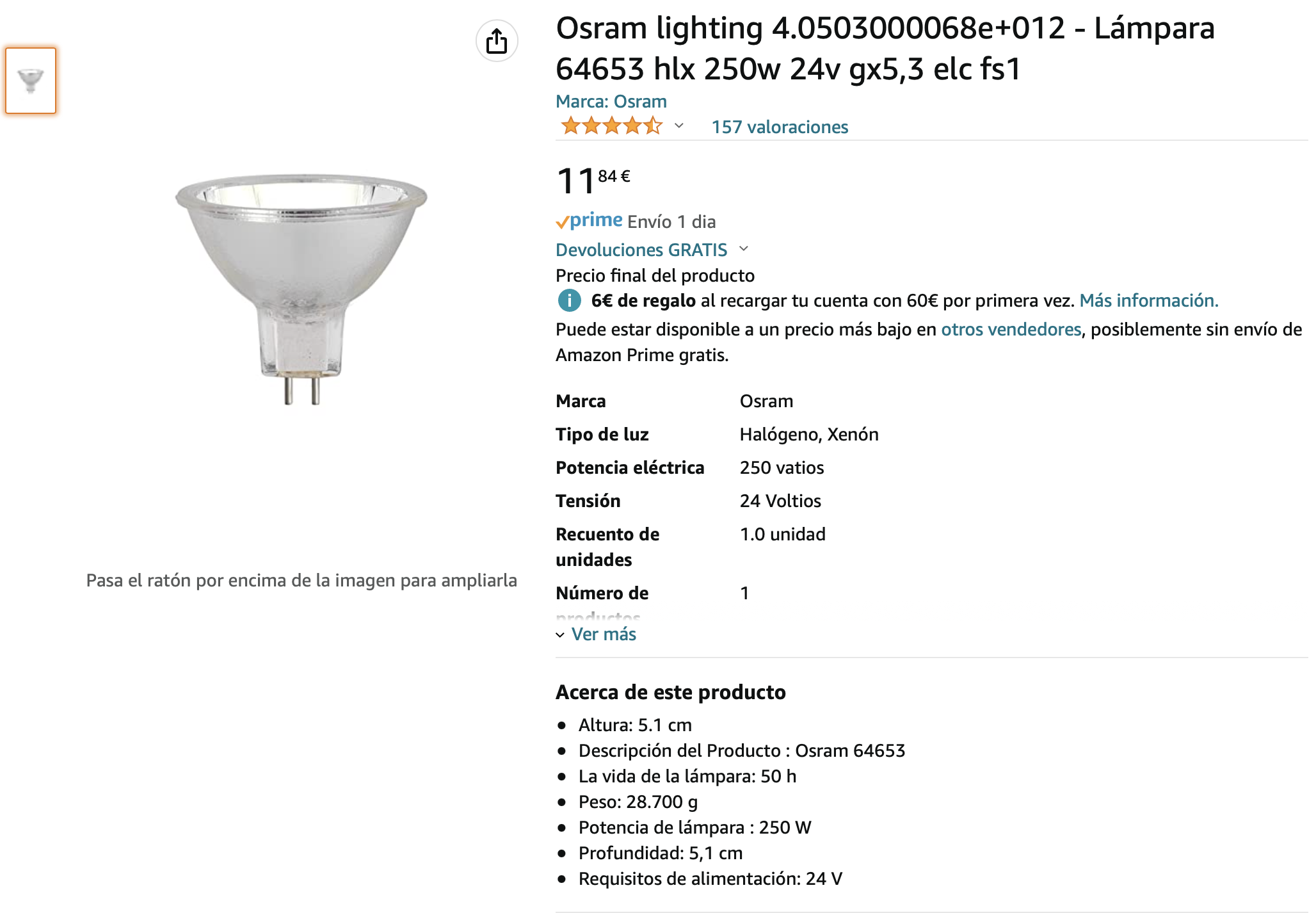

I recently bought a new bulb for it since the old one died. It's a 24V 250w bulb (as indicated in the power suply).
Everything seems to work properly as the fan gets on once I start the enlarger trough the power supply... but the bulb won't turn on. I checked everything and there are no signs of broken cables and all is well connected.
Could someone help me out? I don't know if I should get another bulb or maybe is there something in the power supply broken?

Hi. I have experienced similar problems, which were caused by the bulb mount/socket. The connection was a bit loose and I managed to get mine working by wiggling the bulb a bit. It's not 100% satisfactory but the bulb connector is a pretty standard item and (should be) fairly simple to replace.
Kino
Jan 20, 2006
7,771
Orange, Virginia
Those pin-based bulb sockets are notorious for arcing and eventually burning out. I have had to replace several in enlargers and movie projectors.
Luckily, as Scrufftie states, if it is the socket, they are fairly simple to replace; most have two leads and twist-on wire nuts for the connections.
Here is the manual which shows the lamp replacement method: http://manuelsphoto.free.fr/LPL7451.pdf
Hopefully, replacing the lamp socket would be as easy as tracing the wires back to the connectors and attaching a new one.
If you can't find the exact Jobo/LPL socket, look for a OSRAM replacement; often they are the same.
Good luck.

In addition to the advice above, I'd suggest measuring the voltage on the lamp socket to verify it's being powered. If not, measure the output voltage on the power supply to exclude the possibility of a broken cable. If neither the cable nor the socket are the problem, the power supply itself will need to be inspected. Defects in such units are quite common.
