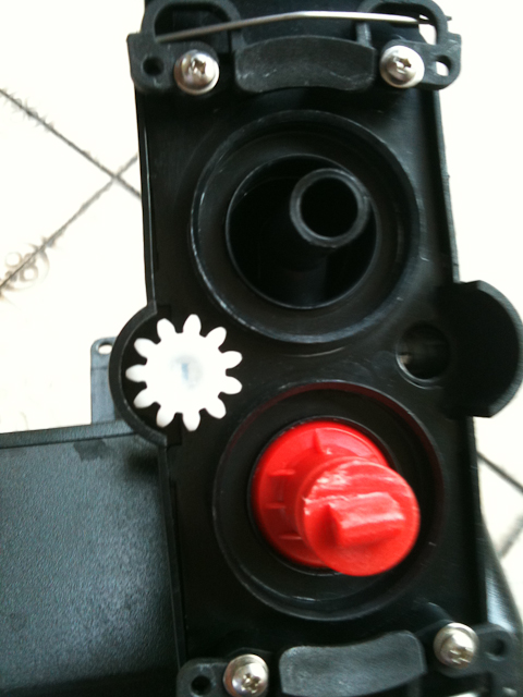

I just acquired my first ever Jobo, which is a CPE2+ with lift, which I'm so thrilled about. I just had it delivered today from Germany, where I bought it from. I'm still in my office right now so cannot test whether it's working as described. But from inspection, the lift may be missing something. Please look at the photo I attached. Appreciate those that are familiar with the item could identify the missing part in my case.
Please pay attention to the white cog-like thing. It seems originally it must have been a pair, but in this case the lift comes with only one. What does this thing do and whether its missing pair is critical. Also appreciate if anyone can tell me where I could locate spares for it.
Thank you so much in advance.

Great... that's a relief. Thank you very much Scott for the confirmation. Can't wait to get back home and have a test run of the machine. Thank you thank you. I'm not familiar with the machine so please excuse my ignorance and unfounded panic :smile:

Yours is like mine, only one drive cog. It can be placed on either side of the unit, hence the extra space.
I guess Scott types faster than me, plus I had to look at mine to verify(just got one as well).

I think it is meant to be that way, I think the hole is for parts on the bigger processors I think (like the ATL series). I have a cpp2 with lift and it works fine without it.
Not sure where to get parts, apart from searching ebay...
They are handy processors, enjoy.

As stated by Scott et al, it is exactly as it should be.

In my Jobo lift (which I use with a CPP-2) the white cog is on the right side, the red cap is on the upper hole, and the funnel is on the lower hole. This configuration of mine works with 1500 series Jobo tanks.
I imagine that the funnel on the upper hole is needed in case you use a tank of a larger series, e.g. an Expert Drum. In that case you would swap the content of the two "holes" and maybe you have to change place to the white gear.
Your present configuration seems to be the one for the larger tanks, and you might have to move things a bit if you want to use 1500 tanks.
