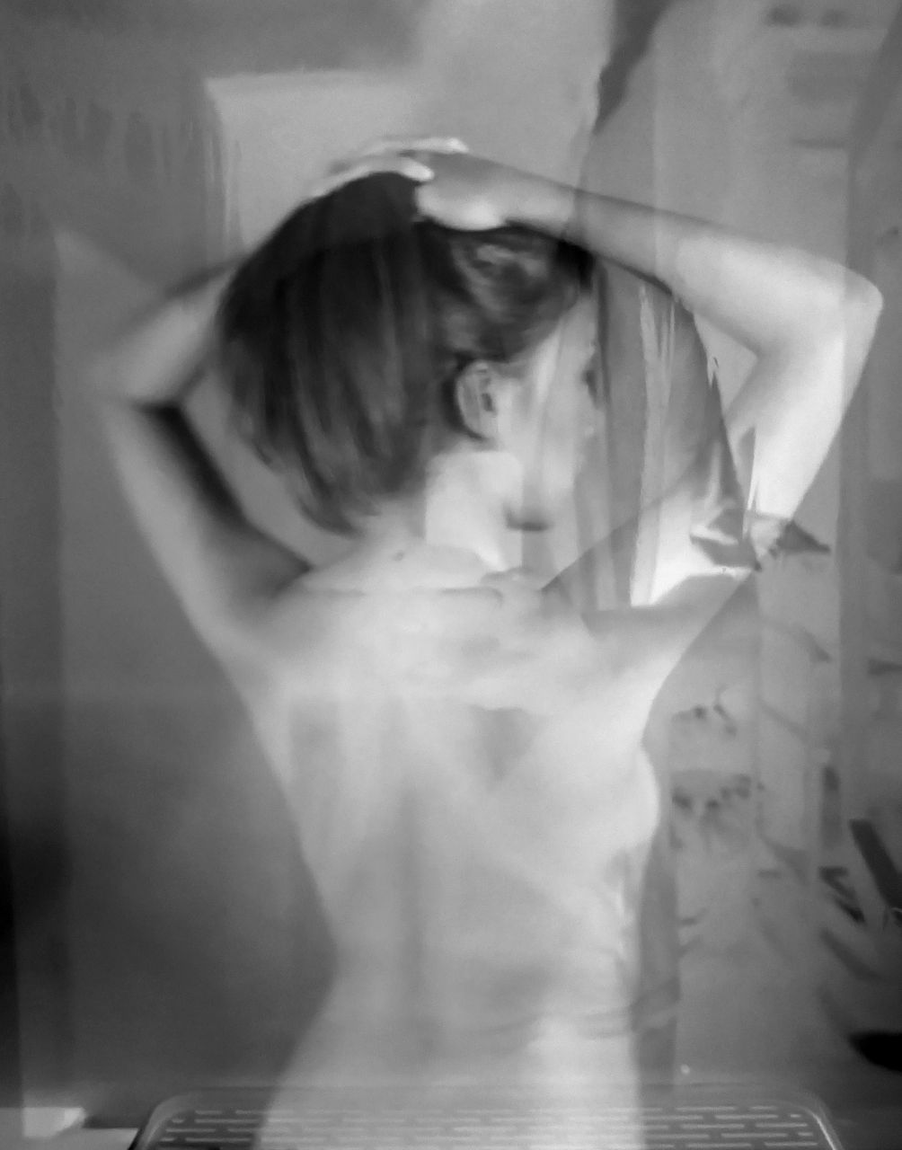

Here's an example, I am using a 3062 drum on a Stark Rotary base. It's a single streak for the past three or four negatives I have encountered it on the same area.
As mentioned never experienced it before.
I can't see a streak.

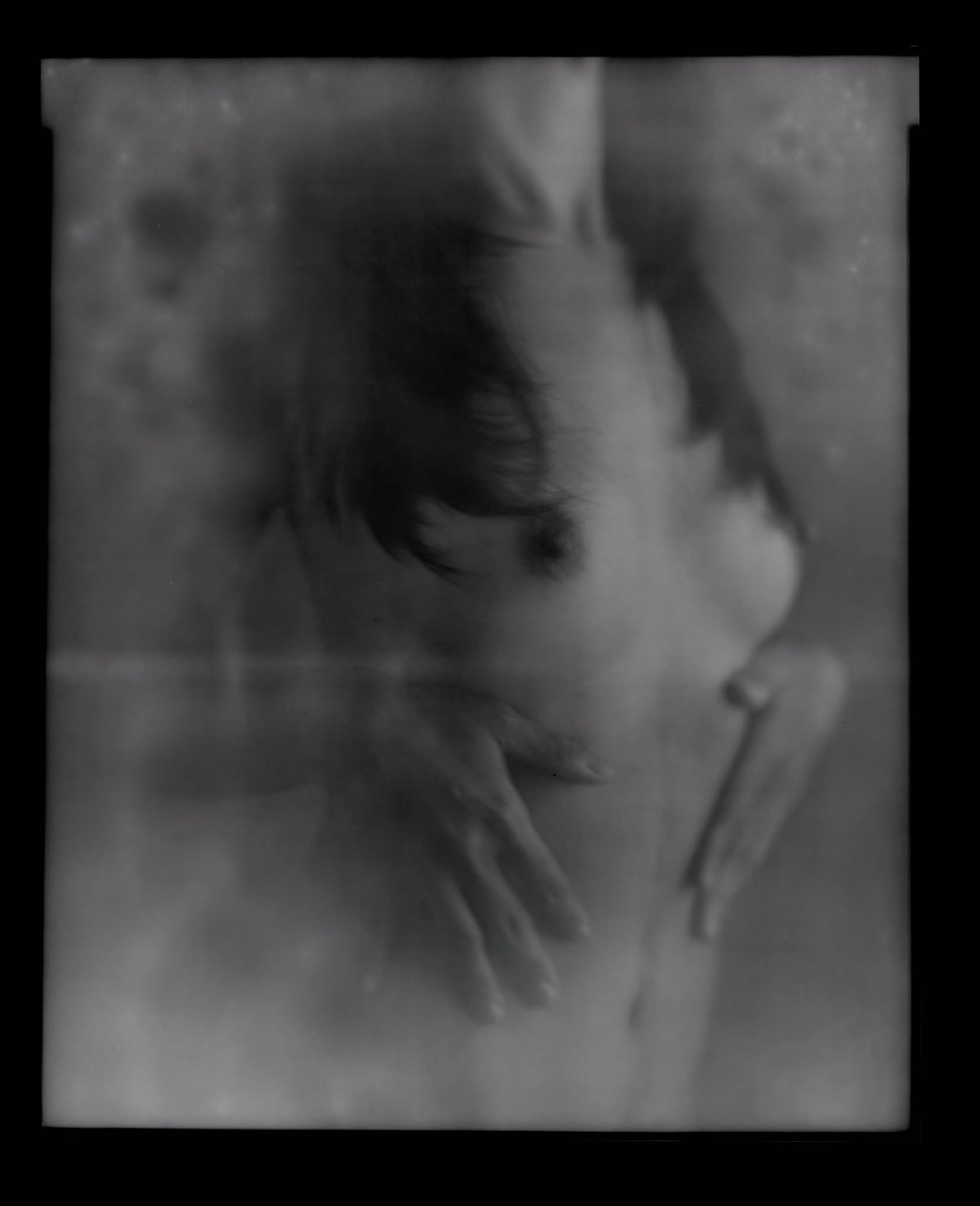

Here are inverted examples it's a horizontal streak

Those stipes are quite defined for chemical. Are you certain it's not mechanical?
Vaughn
Dec 13, 2006
10,283
Humboldt Co.
I agree. It does not look like a chemical issue… Perhaps a light leak or perhaps, as suggested a mechanical issue.
koraks
Nov 29, 2018
26,864
Europe
The horizontal line shown in some of the sheets does remind me of that.
This one looks like at least in part a processing problem, with the edges of the sheet having been exposed to the fixer for only a small part of the time:
messenger_creation_95725694-183f-4d2d-b56e-1c61dec954e4-jpeg.415843
There's also signs of foaming in the partly processed areas.
@Jurgen Estanislao does that sheet show signs of incomplete fixing? What happens if you re-fix it?
