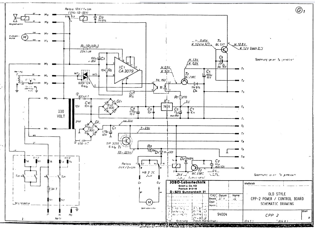

I'm rebuilding the power board of a JOBO CPP2 for a friend of mine. There is some oxidation, corrosion and some burned traces from it cooking in water that sat in the bottom of the case. I've been working my way through it repairing traces, reflowing solder and replacing any failed components. The circuit seems pretty straight forward but there are differences between the published schematic (version 2 board) and some of the actual component values on the board.
I was wondering if this was there result of a previous repair where someone grabbed off the shelf replacements, or if it was a production change (which there were probably many over the years). The question I have is are the differences simply based off of what was available off the shelf? Or is there an engineering reason for them? For example the primary filter cap on the high power DC side is shown as a 420mF electrolytic on the schematic but the burned one I pulled off the board is 2200mF ( I can speculate on reasons why one value would be better than the other ie: higher inrush current at start up with the larger cap which could stress the rectification components vs loading down the power supply when the motor is running for the smaller value). There are some other small changes like this that don't seem vital to operation but I thought it would be prudent to check in if anyone has experience with this particular circuit since the choice is to restore components to the published spec, or to replace things like for like with the values as found on the board.

I list the discrepancies in a few. C1 on the power board is one of the changes. It's a version 2 board per the manual.

Other changes on the board:
D1, spec'd as an 1n4001, was replaced with a jumper. On the schematic it looks like it's functioning as polarity protection. Someone decided it wasn't needed and they could save the 3cents?

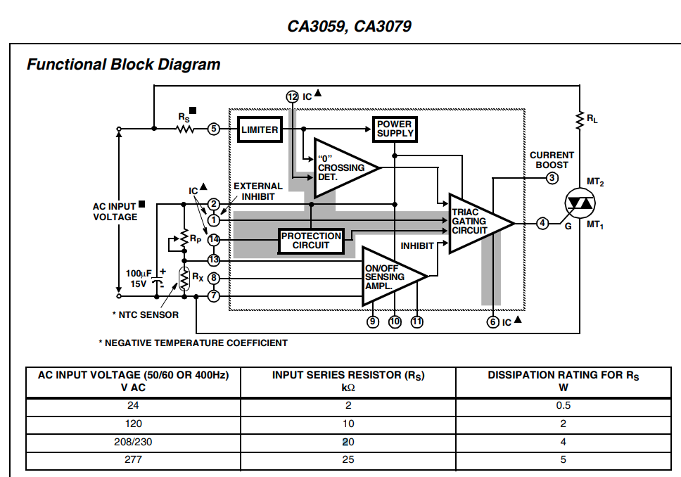

R4 is a 10k high wattage resister instead of the spec'd R2||R3 42k resistors that would give a value of ~21k. R4 is 'Rs' for pin 5 of the CA3079, the data sheet for the chip indicates a 10k 2 watt resistor for 120VAC input and....
Ooooo.... just answered my own question there :smile:, the board was probably printed to accommodate 220VAC and 120VAC mains with component changes. So 10k is correct for 120VAC mains, at least by the data sheet. So that problem is solved. Thanks for the query, it made me think :smile:

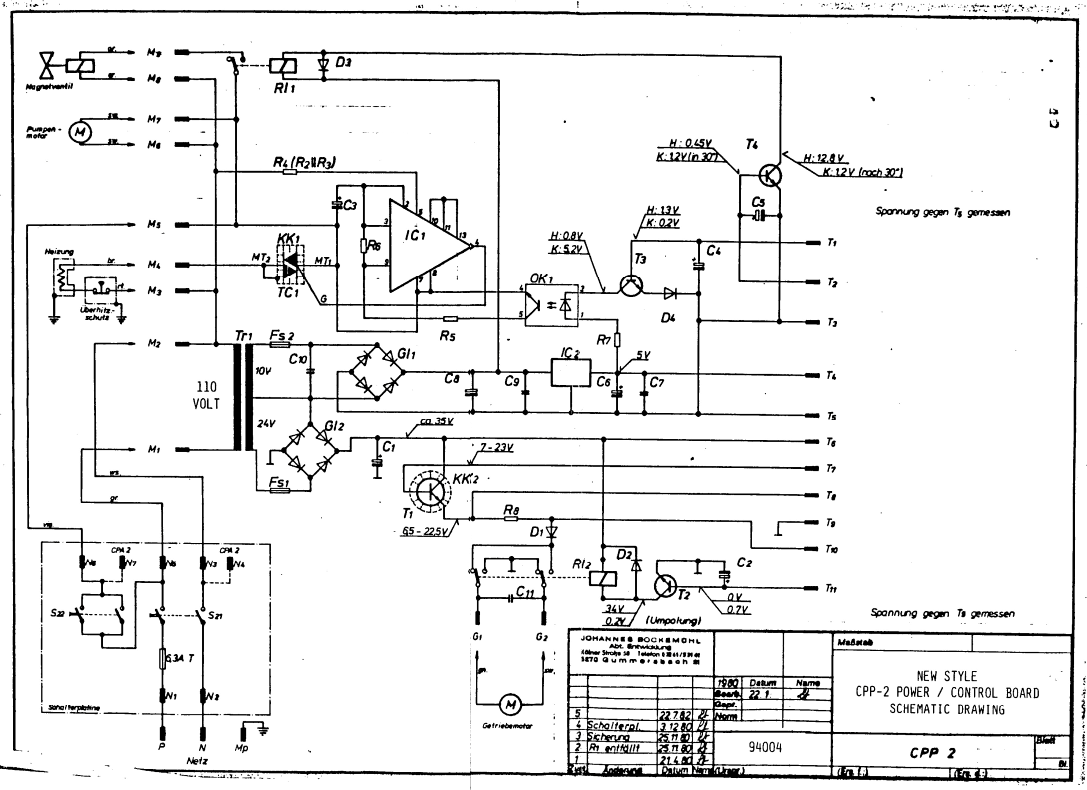

Thanks; here's the power supply schematic:
I think D1 probably blew and someone jumpered it. This is NOT a good idea; D1 protects the rest of the circuit from the back-EMF of the motor coil, which can cause a momentary polarity reversal on the power supply rail. While damage as a result of this is not very likely (mostly due to clamping diodes in any IC's on the same power rails), it would be a nightmare to troubleshoot the problem if it would occur. You'd keep swapping out IC's that would work for a while and then give up the ghost for seemingly no reason...
Yep, that sounds good, although it's a little odd that the transformer is indicated to be for a 110V primary winding. Given the different typeface on the lettering, I assume the '110V' was overlaid on the original schematic and they forgot to change the value for R4.

The 10k power resistor for R4 tracks with the data sheet for using the CA3079 with a 120VAC supply. So all is right with the world again.... Or at least this small part of it.
