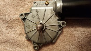

The brushes have about 1/4" left on them ahead of the lead: I don't know if this is good or bad. The gearbox looked clean-ish to me: wine-colored grease the consistency of petroleum jelly, not too discolored with metal particles.
Here's a photo of the motor before I got greasy taking it apart. It's marked at manufactured in 1984 and is 24v.
attachment.php

I had the motor looked at by a service that repairs small DC motors and the motor is in good shape: the brushes are long, the commutator was fine, it passed the "smell test", bearing were good, and the gear box was indeed clean. So the motor wasn't the problem.
I cleaned the contacts to remove oxidation, even on the board, using DeoxIt D5. I tested the voltage at the motor contacts and they read 21v-5v depending on the motor speed. I connected the motor and it ran stronger than ever! This time I could not stop it with my fingers.
The next problem is that the main cog: the motor shaft spins easily inside the expansion bushing that couples the cog to the shaft. This could probably be fixed with JB Weld but I am investigating different options.

I installed a new collet and and cog. That did the trick.

Initially the motor would stop under ballast. If I removed the cog, I cog easily stop the motor by pinching the motor shaft with my thumb and forefinger. On the advice of multiple people I decided to inspect the motor. While the motor was out I also inspected the circuits and observed that there was a lot of corrosion on some of them. I cleaned these with Deoxit, reassembled the motor and wired it back to the board. At this point I observed that the motor was considerably stronger, that I could not easily stop it with my finger and thumb. It was clear that corrosion was the primary problem.
With the motor working stronger than before I was able to observed that the main cog did not have a strong bite onto the motor shaft. It would spin freely after applying moderate friction. The cog had a hairline crack in it and the collet was loose. The loose collet was the hardest component to observe since it is hidden behind the cog. This secondary problem with the loose collet resolved the entire issue.
