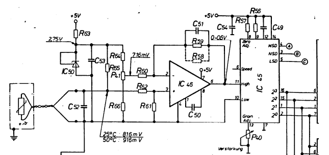

For reference, here's the schematic of the temperature signal conditioning circuitry;
New style unit (pdf page 73):
The dangling net bottom left connecting to C52 is analog ground.
Old style unit (pdf page 73):
IC45 (new) = IC48 (old) = CA3162E (ADC; https://www.experimentalistsanonymous.com/diy/Datasheets/CA3162.pdf)
IC46 (new) = IC49 (old) = CA3140E (opamp; https://www.futurlec.com/Linear/CA3140E.shtml)
Note the reference voltages you can check at the upper leg of the probe; this will tell you (with a reasonable degree of certainty) whether the temperature probe/NTC is OK.
