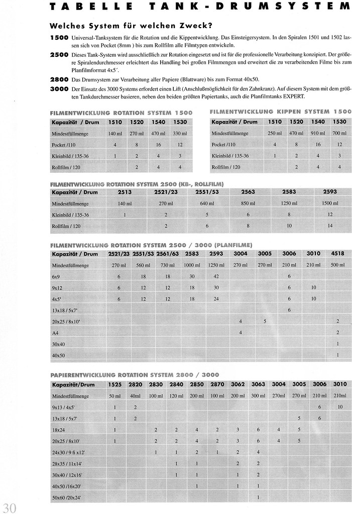

Volumes of the Jobo tanks in reverse and rotary:
