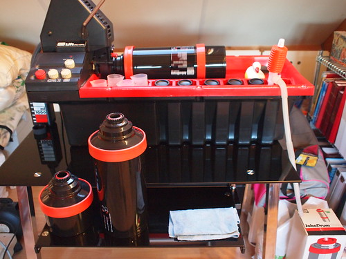

Hi All,
I have been offered for sale the following Jobo CP 4111 kit:
I know absolutely nothing about these machines, I have up to now been doing my processing by hand in metal tanks. I have a couple of questions:
  • The seller claims that it' 100% complete and in working order - basically what you see in the image. Does it appear to be? For example, are there any other attachments / probes / wires / gadgets that this thing needs that I would be missing?
  • My primary interest in this thing is to develop 4x5in film, B&W, as well as exploring E-6 processing at home. The secondary benefit, I guess, is the possibility of doing larger prints that what I can currently with trays.
  • Which film processing tank(s) would fit into this thing (if any)? I understand this is an older generation of Jobo machine.
Otherwise, any recommendations or shared experiences would be much appreciated. The machine is not close enough for me to inspect, so I will be buying "blind". The price will be about $180 (with a free Fujimoto enlarger thrown in, that I do not need...) - worth it? It's far enough to be a weekend-away drive for me, however!
Thank you in advance for your shared expertise - this forum is a wonderful resource.

Yes, this is a very old generation Jobo rotary processor.
If you want seriously do sheet film (4x5"- 5x7" or 8x10") you have to go to their Expert drums. But these (30xx) drums will only fit into the newer models CPA-2 and CPP-2 processors. Also the temperature regulation is more precise,+/- 0,2C. And these processors can be equipped with an elevator which is very handy in short developing times like C41 and E6.
This is my setup: CPA-2 with elevator. I modified the unit with the latest elevator model from Jobo. Costs about Eur. 200,00 for the whole unit plus (new) elevator. Also a re-circulation pump is built in and the temperature regulation is indeed very precise.
best chance is on German E-bay or Dutch marktplaats.nl

Any insights as to the machine would be appreciated :smile: Specifically, the actual dev tanks for 4x5in that will fit it, etc. How does the machine measure water temperature - internally, or does something plug into the front panel?
I really want to get into E6 4x5in development myself (been doing B&W exclusively for years) - and I am hoping this machine might be the ticket?

I think you might be disappointed with this Jobo for 4x5. The problem is those tanks probably will not take standard 2509 4x5 reels. They look like early Jobo tanks that are different I believe. But I could be wrong..anyone know about these old Jobo tanks?

Domaz, you seem to think that I would be out of luck with this processor for developing 4x5in film - what would you recommend instead? I would like something that can both do film, and large print drums, if possible.

The general working principle of this machine seems to be, from the picture, like the one of the CPP-2 and similar processors. There are two basins with water. The lower basin keeps the chemical at the right temperature. The upper basin keeps the tank at the right temperature. A water heater coupled to a thermostat keeps the water, and therefore all the "system", at a certain temperature.
From what I see this should work like a Jobo processor without "lift". The tank is coupled to the processor via a magnet. The operator must manually detach the tank from the processor (winning the small resistance opposed by the magnet), open the lid, empty the tank, fill the tank, close the lid, couple again the tank with the processor, "countdown" the process time etc.
In a Jobo CPP-2 (the best in this kind of technology) there is a pump which circulates the water between the upper and lower basin, and a water heater which is controlled by a thermostat with a digital display, the temperature can be set every 0.1 °C and it generally oscillates for a few tenths of seconds some 0.3 or 0.4 °C on both sides of the desired temperature (total temperature excursion measured by the machine reaches 0.6 or 0.8 °C at most). This is the temperature at the thermostat. I suppose the temperature excursion on the whole mass of the processor, and on the chemicals inside the plastic bottles, is much more contained.
What makes the difference in these kind of processors is:
- how much torque the motor has, and which is the maximum size of a compatible tank;
- how precise is the thermostatic regulation;
- how many slots for water and chemicals do you have.
I wouldn't worry about the number of slots, for E-6 the only critical temperature is the one of the first development. You can keep all other baths warm within a certain temperature range (33 - 39 °C) so no problem there.
As far as the first two points are concerned, you should seek information about this machine to see if it can satisfy your needs.
Other processors, like the Jobo ATL series or another called Phototherm IIRC, can operate all the chemical and water changes automatically. I use a Jobo CPP-2 and I find that I don't need a more automated processor as I would execute one batch per day, maximum two per day. A complete E-6 process lasts for around 40 minutes of which only the first 7:30 (first development) are critical. During the rest of the time you can operate "loosely": you can answer a phone call, or going to the bathroom, or clean your kitchen...

Since LF sheet processing matters to you, find out if you can use a 3010 tank with this processor. I don't think you can, and I think you should hold out for a processor that supports the 30xx Expert tanks since everyone seems to agree that all of the other Jobo options for 4x5 produce visibly less even development. At a minimum, find out whether the tanks can take 2509 reels and what reels are included with the processor.

Thank you all for the informative replies - it has been extremely helpful. The seller is not very knowledgeable, but I will try and find out if it supports the Jobo Expert 3xxx drums. If not, I will hold out for one that does (e.g. CPP-2).
+1
I perfer the 3010 Expert Drum to the 2509 reels for 4"x5".
