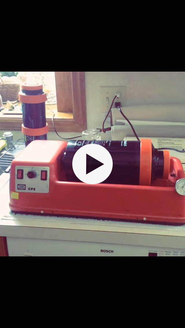

Do you know if there is a way to adjust the motor speed of the CPE (original, not CPE-2). I can't find a manual anywhere...
Looks like this...
