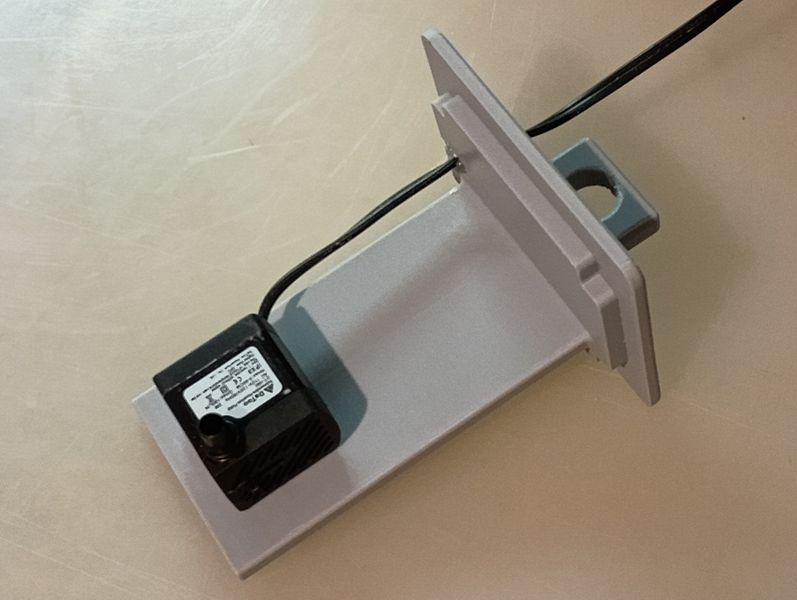

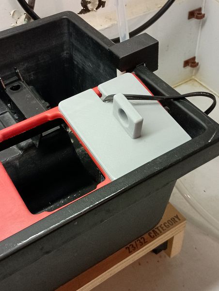

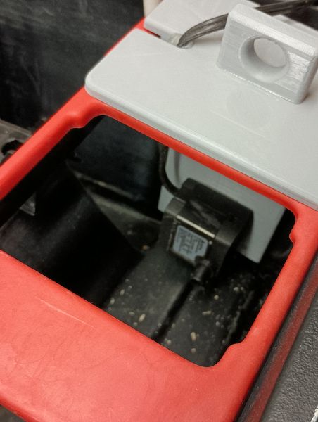

Here's my take on adding a circulation pump to the CPE processor. Might work on other models that have the rectangular openings in the bottle rack.
Bracket was 3D printed using PETG.

I agree, I am not sure how big of a difference it makes. I do know that the entire system comes up to temp faster.
What is not shown is a length of soft silicone tubing that stretches halfway down the length of the tub. The unit (without the tubing) can be placed in the very left bottle opening and face towards the end of the unit farthest from the lift/control.
What I was after is a removable unit, thus the design. I got bored at work and fired up Fusion360 to occupy myself in between phone calls.
