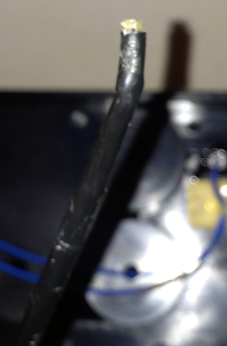

Sorry for the double post, this is the end of the wire that comes from the potentiometer, and ends up in the bath, near the heater-element. The other wire looks pretty much the same, but a rounder "tip" on the end...
It doesnt look much like a sensor :tongue: Just a goey mess on the front, looks and feels like some glue. Is the sensor itself under the black covering plastic ? The wire is much more stiff the last 20cm or so.
The temp sensor is a thermocouple, i.e. two different bits of metal stuck together. It looks like basically nothing - a couple little wires come together in a blob.
It will be the one that goes to the potentiometer. To see if it's OK, measure the continuity of the whole sensor-and-leads - it should be basically short-circuited, i.e. under 1 ohm. If the sensor shows an open circuit at the board end, it's broken. You will need to disconnect one lead from the board first so that you're not measuring other impedances in the board.

After taking a closer look, the two sensors, the "heater protection fuse sensor" and the "temp sensor", each only have one wire connected. One goes to the potentiometer and the other goes to the fuse protection unit.
So there is no way to measure the resistance between two wires on the temp sensor, since its only one. Strange.

What you see is a mechanical capillary thermostat. There are no wires to measure resistance. The best way to get it working is to contact catlabs and get a replacement.
