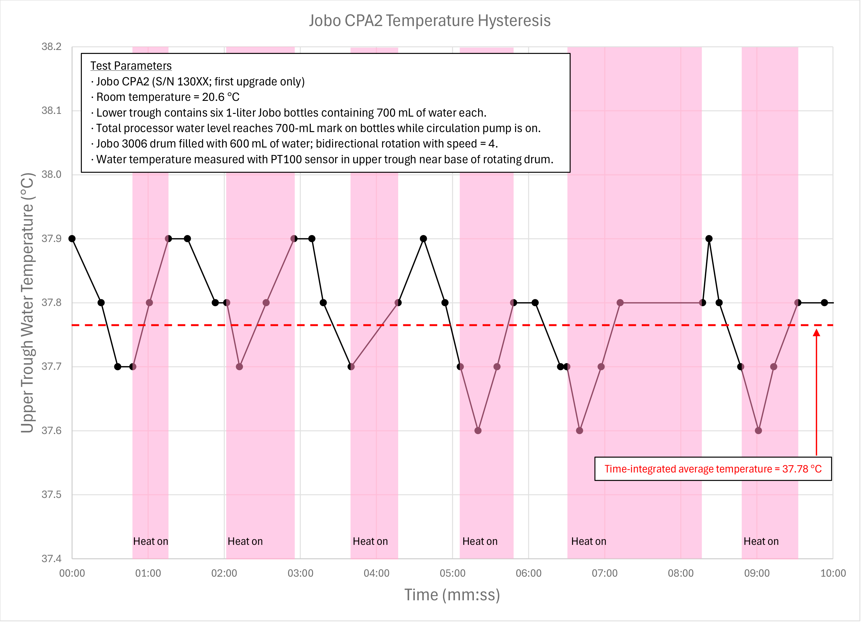

I wanted report back with a little data that addresses the question in my original post. I found a CPA2 in basically unused condition for what I considered to be a good price. It's an earlier serial number (first upgrade only) but my research on the issue of serial numbers and Expert drums seems to indicate that an earlier unit with at least the first of the three motor and circuit board upgrades is typically fine as long as you don't drive the motor too hard by filling the drum to its volumetric limit (e.g., >1,000 mL). Time will tell, but it's an extremely clean unit and I anticipate I'll at least get my money's worth out of it.
I set up an experiment to measure the variation/hysteresis in water temperature in the upper trough under real-use conditions (e.g., with semi-filled 1-liter bottles in the lower trough, with a drum rotating on the lift, etc.). On my unit, I had to set the analog dial to 36 deg. C to achieve an upper trough water temperature of 37.8 deg. C (to mimic C-41 development), but the inaccuracy of the dial doesn't bother me and is a known shortcoming of the CPA2. I recorded the temperature change over the course of 10 minutes and noted when the heater turned on/off. In short, I was very pleasantly surprised by the results, which are plotted below:
The temperature stayed between 37.6 and 37.9 degrees C for the entire 10-minute test, which gives a hysteresis value of +/- 0.15 deg. C. Keeping in mind what Koraks mentioned previously, I also calculated a time-averaged (as opposed to an arithmetic average) temperature, and got 37.78 deg. C, which is negligible error for C-41 development. This should all be taken with a grain of salt, of course, considering that the trough temperature may not be reflective of the temperature inside the drum, but these results do, at least for me, settle the question of whether the CPA2's thermostat maintains an adequately narrow hysteresis band (it does).
I'd like to repeat this test with the addition of measuring the internal drum temperature, but I need to track down a long, flexible PT100 sensor that can be snaked down through the lift and into a 2500 drum (might have one at work). Expert drums don't use a center core, so there's no easy way to insert a temperature probe into an Expert drum, hence the need to perform the experiment using a 2500 drum. Barring a flexible PT100 sensor, I might settle for using a flexible type-K thermocouple that's been calibrated to the PT100 sensor in the upper trough. I'll report back when I can.
