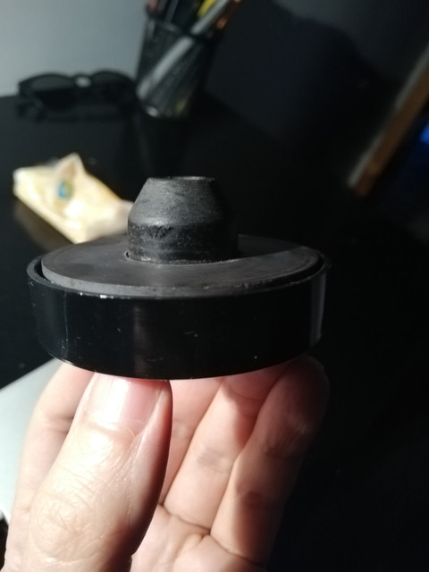

I recently bought a old JOBO CPA and just entered the crazy world of colour printing.
The JOBO is in very good shape, temperature control is very accurate and the water pump works fine (maybe should be cleaned to work smoother)

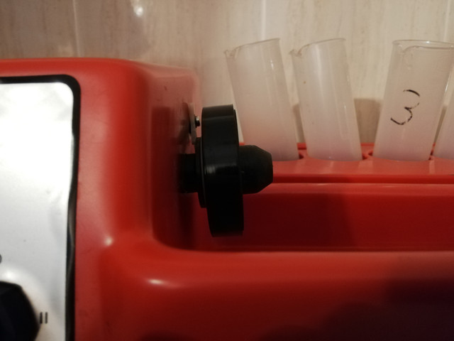

The motor works in the two different speeds, but seems to have some kind of power lack... and at position II (the faster one) works slower in one direction than the other.
Also the drum (I'm using a 2830) is not completely horizontally and don't rotate smoothly

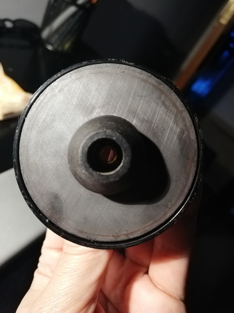

I'm uploading a foto of the magnet and will share 2 videos to let you see whats happening. Maybe you could tell what to do, if it it's necessary. I'm worry if that affects the print results... I'm new and I'm not sure if the quite bad results I got are result of my inexperience in colour enlargement yet, or if it caused by that issues with the motor / drum rotation and subsequent chemistry agitation.

Remove and inspect the drive magnet. The magnet is glued to the plastic and may be loosened. No idea on the speed difference. That's a very old machine. Still it will probably work as is for prints.

Other situation: seems the problem of a non linear rotation of the drum stay in the magnet... It is misalign...
How to disassemble it??

Concerning the magnet driver, I just gave a kicks and broke it! :smile:
Seems it was glued one day. I glued it again and it gets better... But it brokes again when installed at the JOBO.... Let's see what gonna do...

Seems I got a used CPE-2 drive magnet with a 6mm motor shaft holder which will fit the old CPA! That's cooool!!!
