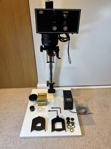

Think im a bit stuck with this, just newly purchased, enlarger head seems very near column and the projected light. is not projecting correctly, seems to be overlapping bottom of column
not great at explaining things as well is an added bonus
How do i post a pic, thats will show it easier, forum says my pics i tried to post are too big
Ta

It seems that this is a relabeled Japanese made LPL 6600 enlarger, or possibly, a 6700. It can be equipped with a dichroic-filtered color head (prints color or B&W). It can also be equipped with a simple condenser head using an opal enlarger lamp. This version is usually used for B&W printing, but might be equipped with below-the-lens filters for color work.
By perusing the links below, you might find the version you have. The first link shows the latest model with the B&W head. Some of the other links show an older version with an old-style color head.

Aye suppose i could try that in lightroom, But think ive just worked out the problem,,,,,Dont think the light will project correctly with the 6x6 negative carrier and a 50mm lens??
seems to be doing the business fine with 35mm and 50mm
I jus bought this because it was cheap with accessories, and i can print the negs from my RB_67, with a 6x6 crop obviously, which i have only shot once since buying it a long time ago
been on the hunt for an LPL 7700 for couple monthe but postage being a problem as im in the North Highlands, so c6600 colour do fine just now
got a saved search on ebay for a 80mm rodagon f4, seem to always miss um, am sure that will sort projection
Ta fur reply

Aye had it apart and cleaned it last night , has a colour head and a small downlighter type bulb, no condenser and an plastic and foam llight mixing chamber

Thats it, Bit of a Muntur, but ive got the lights out so dont need to look at it ;_-)
A 50mm lens doesn't cover 6x6cm, so that's not a meaningful combination to try and get to work. If this works OK with 35mm and the 50mm lens, I'd say everything is A OK.
The enlarger looks very tidy and complete, congrats!
Aye was thinking that, Oh aye its tidy and complete, just ugly, but it,ll do the job i need it for just now
