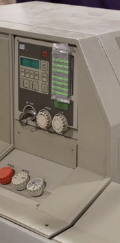

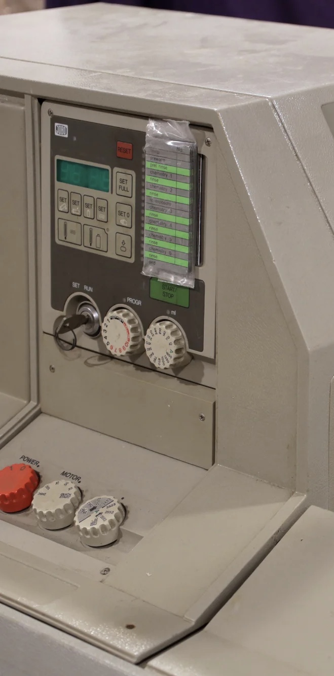

Im working on my ATL3 and im running into issue where when I turn the machine on sometimes it trips RCD in our house and electricity goes off. Today I was fiddling with it again and it tripped but it did it when i moved the SET/RUN switch. My machines is very old and it still uses plastic wheel switch, not as newer machines which have key instead as shown on the image.
So my question is, what was the reason that Jobo put the key there instead of wheel ? Can this be source of my problems with tripping ? Any info much appreciated ! <3

I would assume the key was placed there to only allow "authorized" persons to run the machine.
Since these are lab grade machines, it would make more sense to have a way to prohibit casual use.

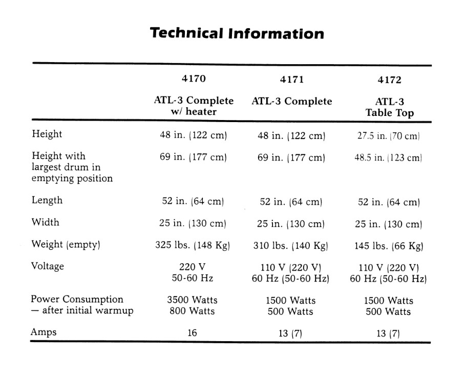

Are you sure the circuit on which the machine is connected has enough amperage to operate the unit? If your circuit is heavily loaded, the inrush current could trip the breaker even if it should have just enough reserve current as specified on the nameplate.
Here is the manual for the machine from an older Photrio thread:
Which model do you have?
If it is the first with the heater, you need to have a dedicated line with at least 20 amps service @220 volts.
