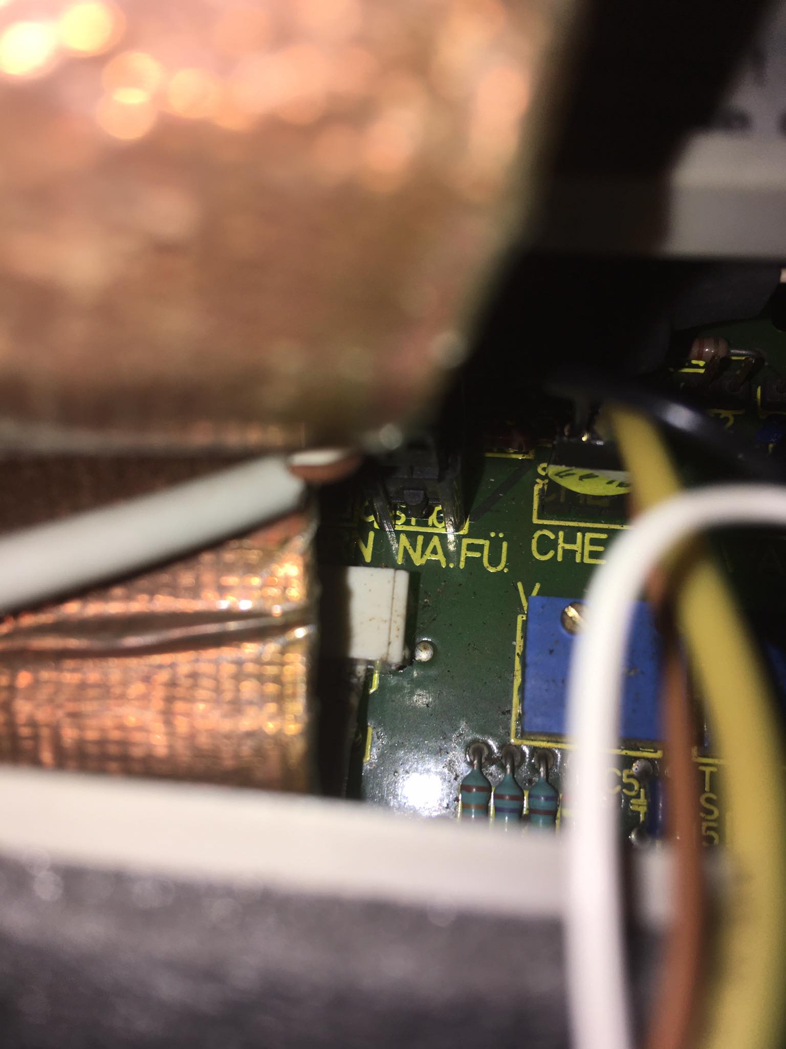

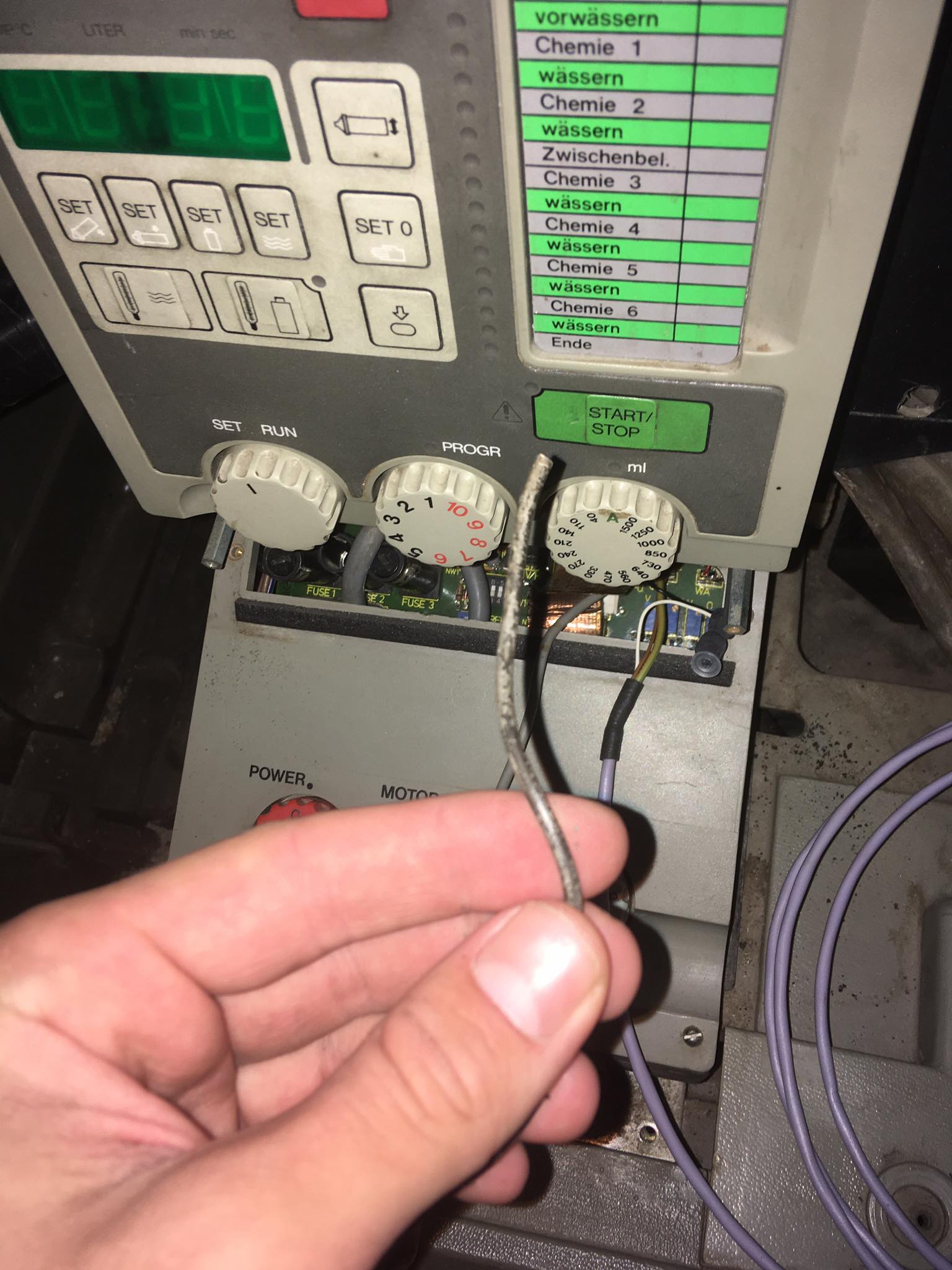

The reason, apart from other information in that manual, i need it for this. I have one cable going nowhere and it was eaten by mice. So it is only bare wire. On the board it goes to connector labeled as " NA.Fü " and i cant find any info what that is and what to replace it with. Any thoughts ? Thanks ! :smile:
AgX
Apr 5, 2007
29,973
Germany
From what I got in my archive I cannot help you.
Though, the only german term that comes to my mind that may make sense is "Nachfüllen" (refill).
Thus it may refer to the "lower float switch". A 2-wire cable.
Think about it...
