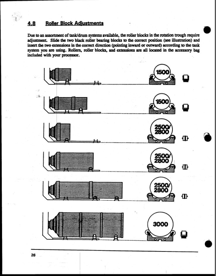

Hi Guys, I've just bought a Jobo ATL2 plus and I'm completely new to this Jobo developing experience, but I saw the opportunity and I took it.:whistling:
Although it's still on it's way, it comes without any drum or tank and I've been struggling to understand if all Jobo's drums work with it (for instance will it work with a 4551 print drum?).
Here attached is a print from the user manual that mentions 1500's, 2500's, 2800's and 3000's.
Additionally, what would be the best choice for developing 120 film (both the occasional roll of film or a batch of 3 or 4)?

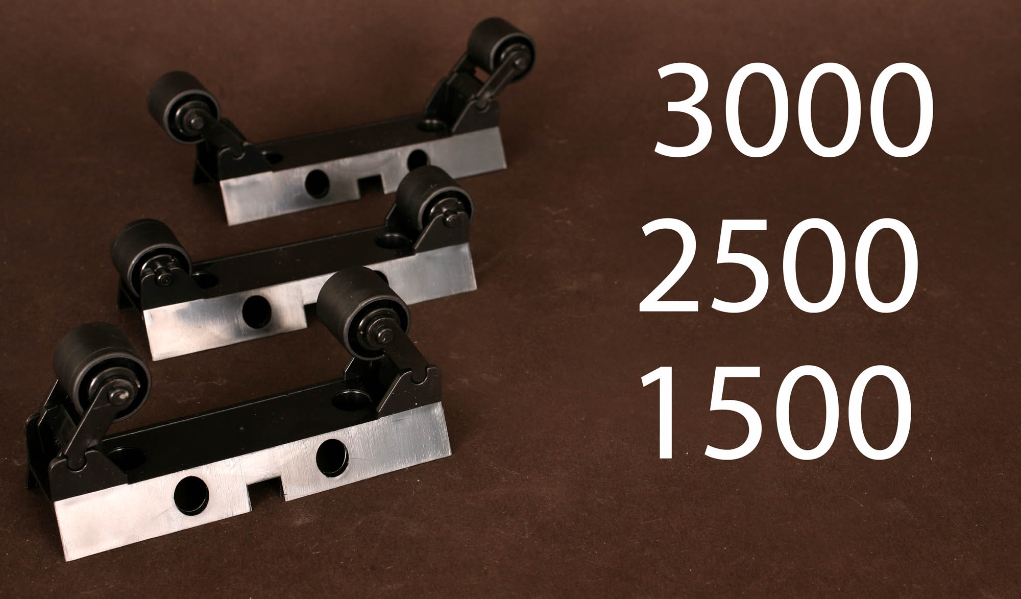

The only relevant point of information is that you will need tanks with cog lids.
As for roller settings:

You could, but that will not serve any purpose but add more friction and resistance to the motor.
The ATL's have a stronger motor, and longer lift arm bed (metal tubes). If you really want to, when using larger tanks, you can add a second roller block directly on the bottom of the tray. Thats what those ridges are for, they secure the roller block in place.
