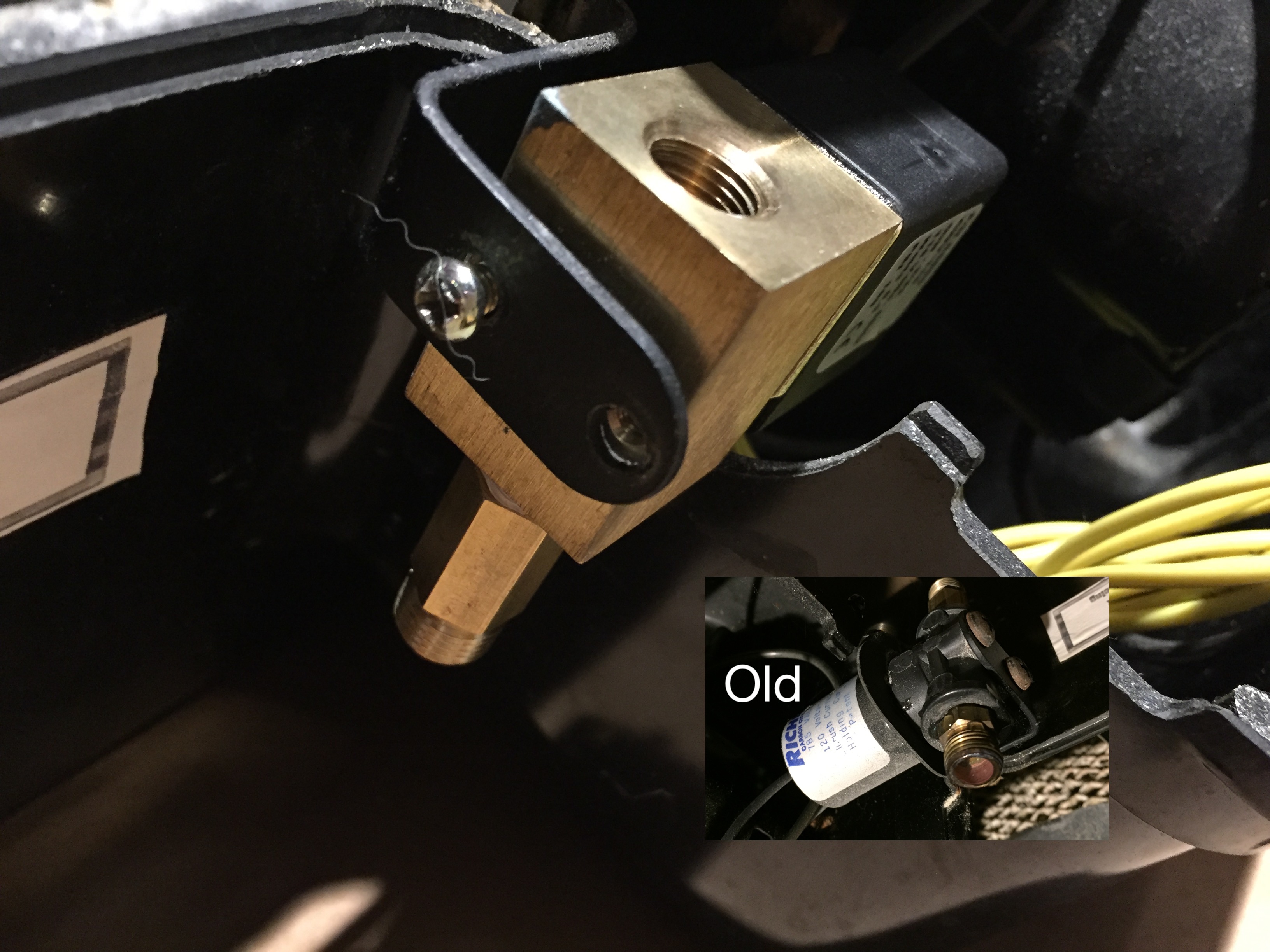

I recently replaced the water valve solenoid on my home's humidification system. These solenoid valves do go bad. Finding a replacement for your Jobo should not be too difficult. Probably looks something like this.
