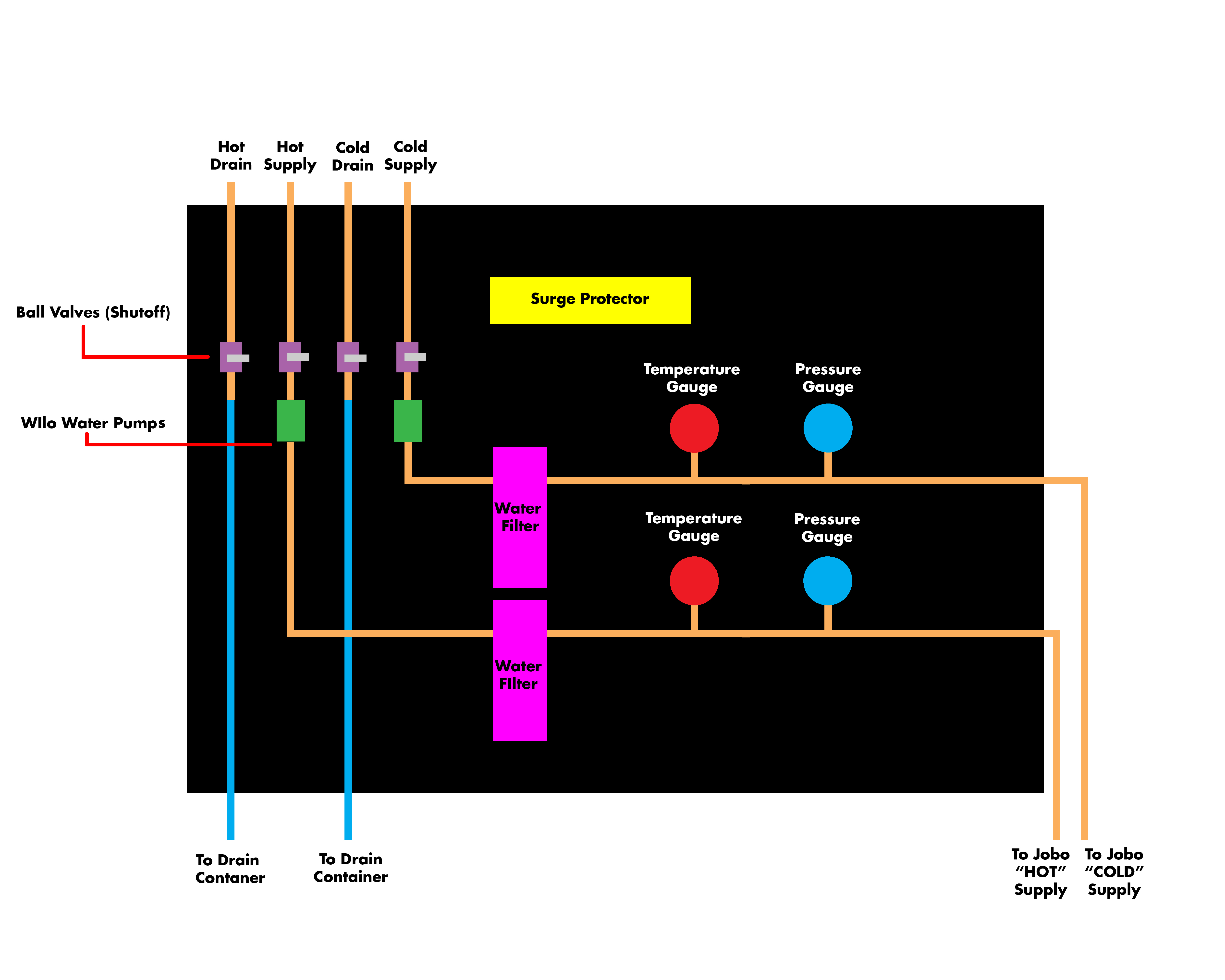

I just picked up a Jobo ATL 3 and now I'm in the middle of deciding how I'm going to place/operate this behemoth. I'm pretty limited on space so I may need to explore avoiding any plumbing changes in my workspace. Would the following plan be feasible? Have I gone crazy?
1. Get one of these IKEA shelves.
2. Put two containers on the top of the shelf. One for tempered water and one for "cold" water. The tempered container would be heated by a Nova Protronic immersion heater and I would probably put an aquarium water circulation pump in it. I would probably put some kind of temperature sensor in the tanks to monitor the temps. Both would be 5 gallon plastic containers like this though.
3. On the back of the shelf I would mount the following "control" board. It consists of some fittings, copper pipes, shutoff valves, water pumps, filters, temp gauges, and pressure gauges.

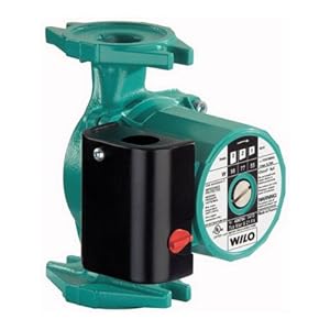

Pump:

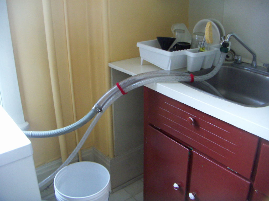

I'd look into a hookup to your darkroom sink with some long hoses and a quick-disconnect. Or have a plumber splice in a ball-valve with the connector of your choice, so you can use pex or garden hose to run to the machine.

Regarding the plumbed system + hose fitting on the sink: The Jobo requires a tempered supply that is +/- 10 degF within the processing temperature. So I don't think that would work unfortunately :sad:.

In general - you are far better off running the machine on cold/cold connected water supply, then with some external source. The machine will pull in about 20 liters for the main trough (long time since i last filled an ATL3, but the manual will tell you), then about 6-8 liters of rinse water in a normal color process run. Consider the machine will also pull in cold/tempered water to balance out the main trough throughout the run, though these are usually smaller amounts. If running 6 bath E6 expect doubt the amount of water (extra rinses), or if you program a custom rinse cycle as well.
When running on cold water only, the only disadvantage is that the rinse is run in cold water instead of the process temp. Small price to pay for the machine to actually work.
Good luck!
